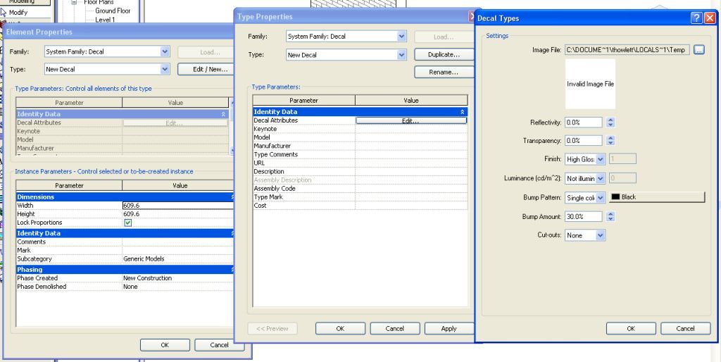

I'm using Revit 2009. I've placed 10 decals on ten video monitors. But when i render the view. All i get is two images. 6 of one and 4 of another. What went wrong? Any help, anyone?

Hey, for every picture you want to use, you need to create a new decal ie picture "a" will be decal "a", picture "b" will be decal "b" and so on. Check to see if your decal's are all the same, and adjust the settings accordingly to produce new ones. You should have 10 seperate decals in the type selector, and they should all have different pictures. When you created them, you may have duplicated them without changing the actual photo that will appear. Click on the decal, go to element properties-->edit/new-->and click edit next to decal attributes. Make sure the file location of each decal is different, otherwise all decals will be the same. Hope this helps =)
