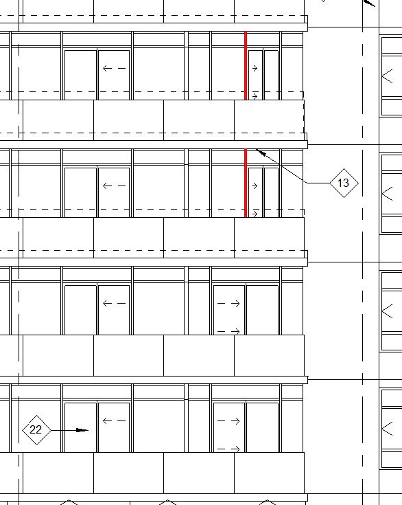

I have a curtain wall that behaves erratically.
It is a balcony window, and has a sliding door on it.
On some floors it works perfectly, on other floors it adds a grid line + mullion (shown in red), that shrinks the door.  Even if you delete the whole system and copy the one below (the one that works) the weird mullion is added.  I managed to exclude the grid segments and delete mullions and make it sort of work... but they keep coming back...
This is driving me nuts...
THANKS!

I would bet that your curtain wall has some predefined max. or min. mullion spacing. When you copy the wall from below revit adds the Curtain Grids based on the default setting. Check your wall.

When you copy, do you get any warnings or error messages?  When you copy up, do you copy up in elevation view or do you use the "Paste Aligned > Select Levels By name"?
Are you saying that you delete that grid line and it just comes back?  That is an odd one.
