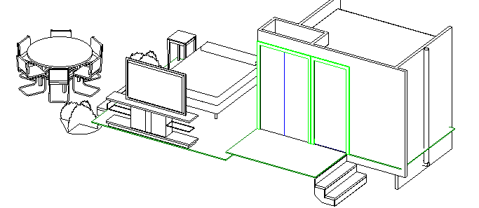

 Well i looked over some old posts that had the same topic, but they dont help me. Can anyone tell me how to get the green line gone from my 3d view? See the SS below.

Did you try turning off all lines, more specifically room seperation lines?

Yea all lines is set to black and i tryed to uncheck them in Visibility/Graphic Override.. And i still got green lines... : /

Look in your settings - object styles.  Yon may have something set there.

looks like you have a graphics override turned on

Hey, did you create a group and then save it externally? I did that and my lines turned green like yours, and I was wondering have you found out how to fix it?

Nope i didnt fix it in revit, i fixed it AI when i fixed my final outline. I tryed to make all my lines black in object style, but they will still be green. Make a view with the camera in view tool bar, and adjust that, and it could be gone, it think, didnt try it tho.

Did you use the line tool and pick a model line?  The default model line "Line" is green if I remember correctly.

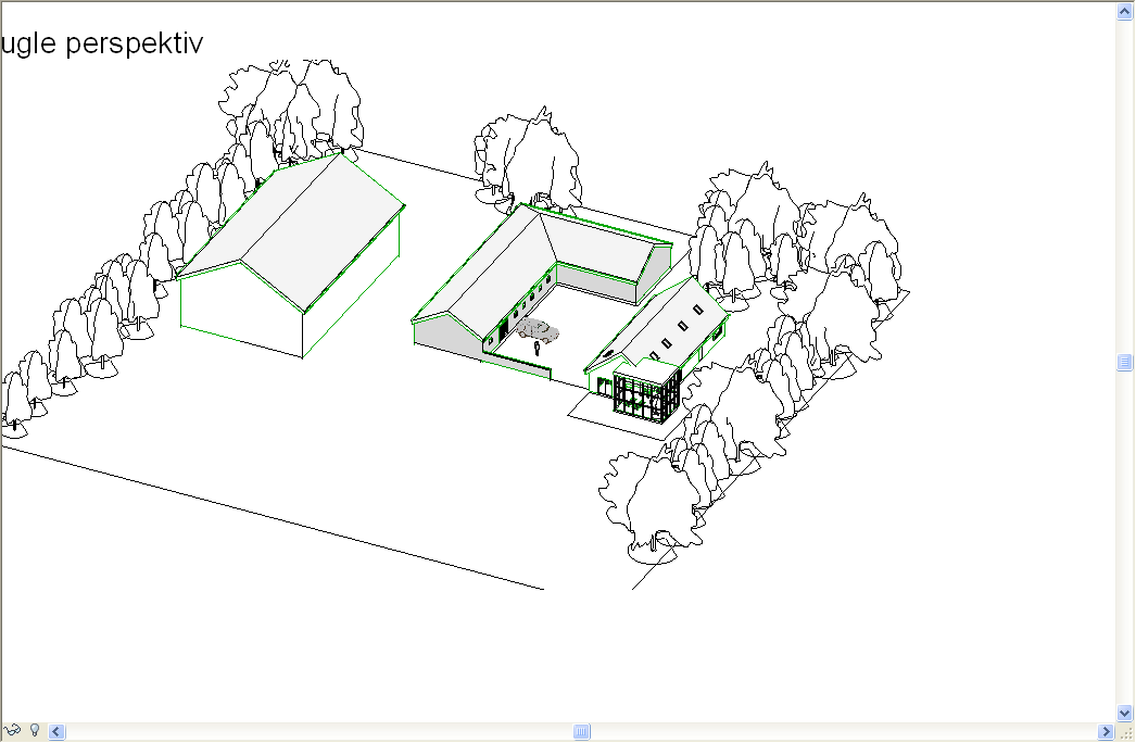

Did you ever figure out how to get rid of the green outlines in your 3d view?

Try going into your View Properties, select Advanced Model Graphics, and make sure that the Silhouette Style is set to <none>.  If it is, try setting it to Medium Lines or some other such line style that you are sure is black.  Please let me know if it works.

I started this particular project in version 2008. version 2009 by default sets slab outlines to green. When I created a new file in 2009, the green outlines threw me off. Simple fix as usual.
