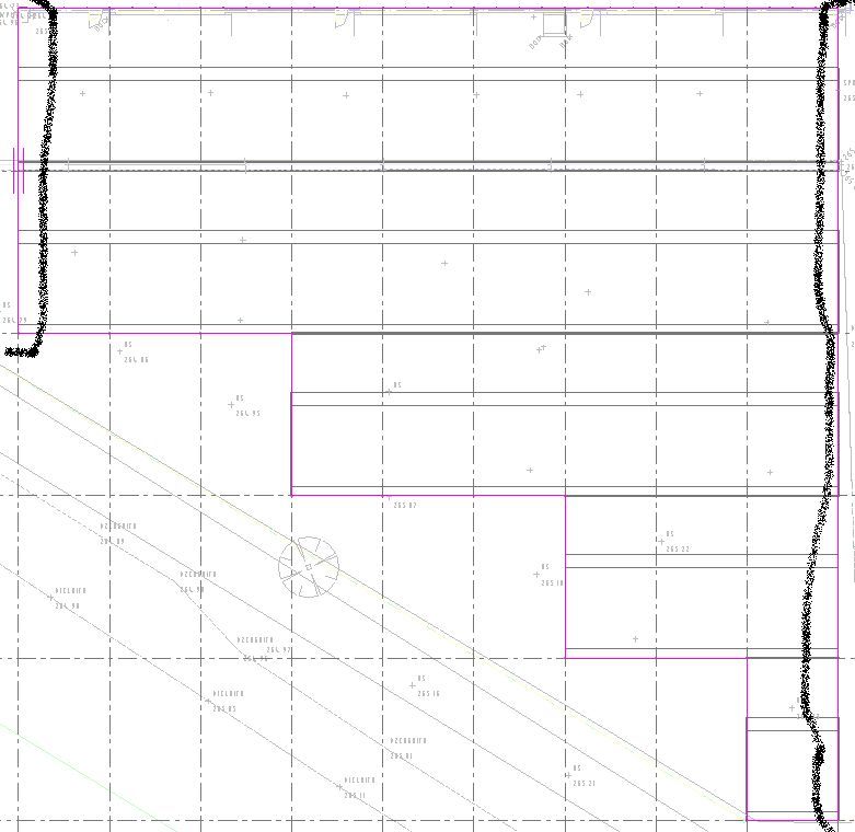

Hey, i created a beam system by going to the structural tab-->beam system. The internal beams are behaving correctly, but my end beams don't show up. The lines with the black line around them don't have any beams on them. Am I missing something, or can't beams be placed on the end? I tried changing the justification to end, centre and beginning, but that did nothing. Any help would be greatly appreciated =) Cheers.

From my understanding the beam systems should be used for filler beams.  The beams at both ends of a "beam system" would not be considered part of the beam system.  So if you have your structure all build and have all your columns in and your transfer beams that transfer the loads directly to the columns, then you use the beam systems tool to fill in beams between the beams that transfer the loads directly to the columns.
HTH
