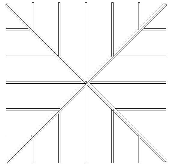

Hey, using RAC2009.

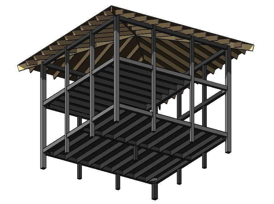

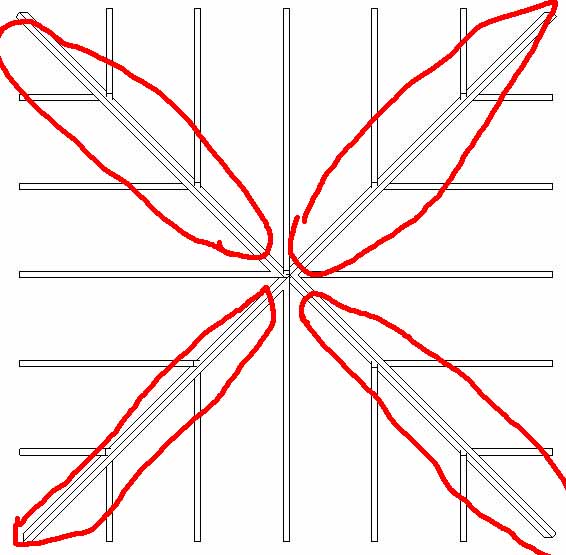

I'm trying to create a sloped glazing roof that looks like a timber roof with battens etc (refer to pics). Its going well so far, but the mullions that are placed on corners are not going the way i want. I want the face of the mullions that are circled in red to be adjacent to the ground. Ill upload my file and see if anyone can get it to work. Refer to the picture of timber beams for what im hoping to achieve.
Thank you in advance =)

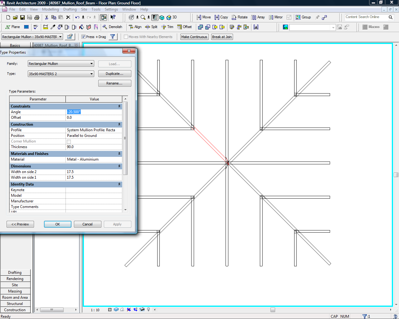

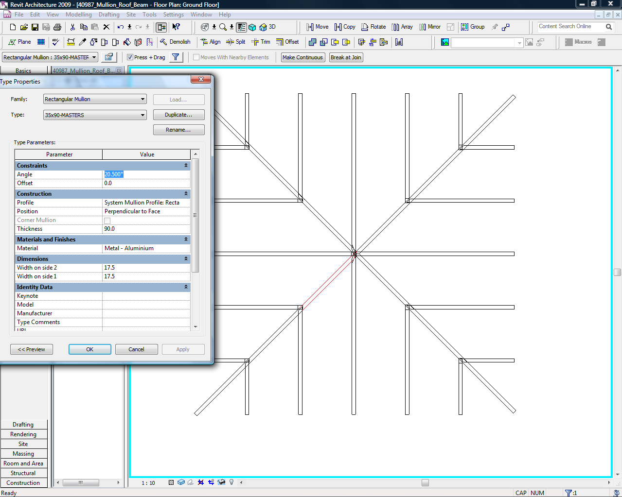

Hi TIMBO, you must duplicate the mullions and watch the angle one must have 20.5Degrees and the other -20.50Degrees... i think this is what you want, isn't it?

Yeh thats exactly what I wanted =) I thought that's what you had to do, but i thought there might have been another way. Thanks or your help mate =)
