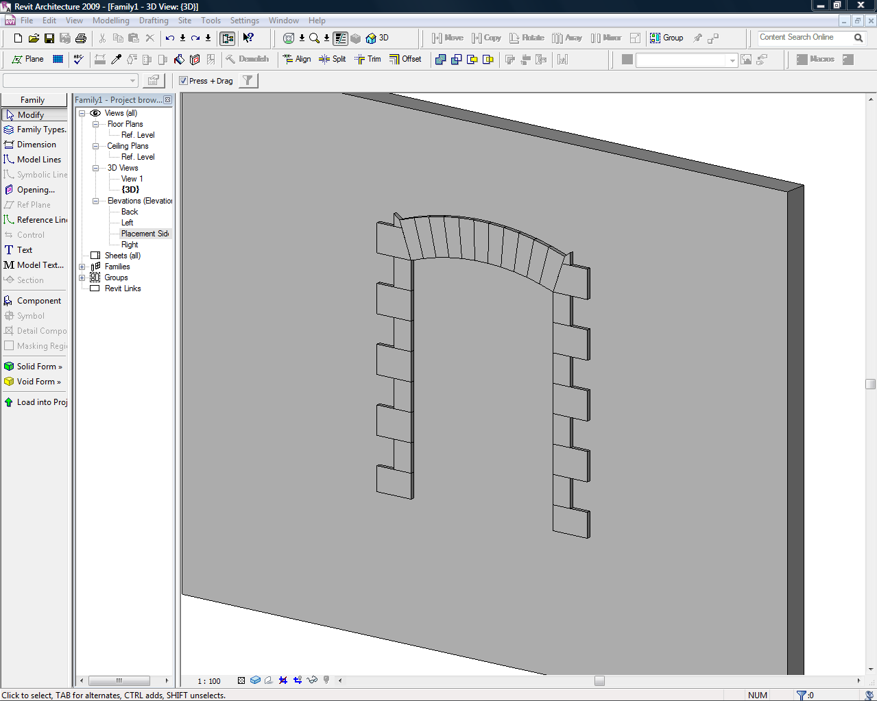

Hi
Anybody know how to do bricks around an opening such as a door or window
regards
Mark

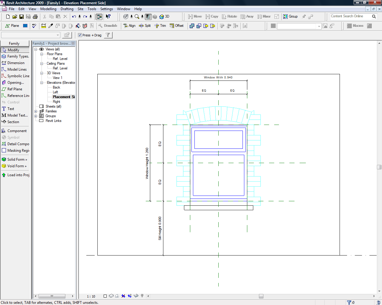

Hi, you can create a "Generic Model Wall or Face based" with this shape (just like a Sweep) then give them the material you want...

Thanks Typhon. You got my brain cells working. I went to Massing, then create mass. I drew around the shape, then extyruded by 10mm. Then finished off with Wall by Face. Then I mirrored it to the other side. It worked. Chuffed or what.
regards
Mark

Also in a Generic Wall Based...
