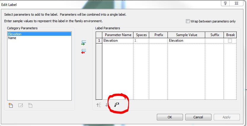

 1. Select the Level family in the project browser and edit it, this will open the family in another file. 2. Select the elevation label, then click the 'Edit Label' Button 3. Select the 'Elevation' label under label parameters, then click the button below the Label parameter box. (Has a hand pointing at # symbol) 3. Change the unit format, save, and load family back into project.

@atlantaarch,
Just wantet to express my thanks, 3 years later and your post came in handy...Autodesk doesn't really make the custom units button for the label that obvious do they?

To add the parenthesis automatically:
1. Open the edit label window.
2. Look for Prefix tab and add open parenthesis.
3. Look for Suffix and add close parenthesis symbol here.
4. Save and load to project
