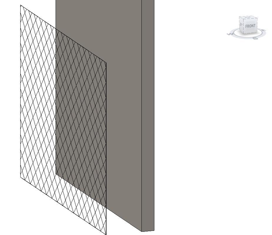

Hey, do these pictures show what you want? The big wall is there to show that the net is transparent, and no rendering has been used.

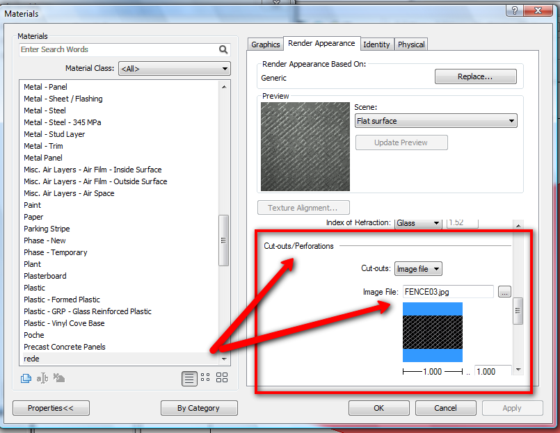

Hi create a Wall for example, and assign the material i post....

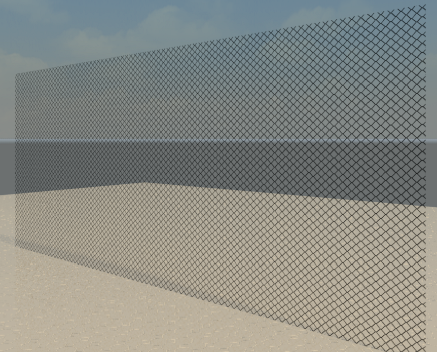

Look the render in medium settings...

Hi WWhub i don't put the material, only the image but i put now...
Pick in the image and save as... or in the folder in revit directory "LOW RES" choose "FENCE03", you have severals with diferent kink of fences...

your net rendering is exactally what I am trying to achieve.  I have saved the image that you have suggested. I created a wall that was only a 1/8" thick and applied the image you posted as the material.  However, when I rendered it, it was not transparent as your rendering showed.  It kept the black background. How did you accomplish the transparent effect?

Simple, are you looking the image i post now?

That worked great. Thanks.
Does that "cut out" feature always work with just a black background?
