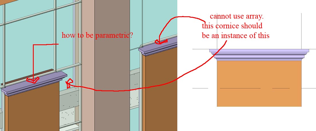

Hi, I've created this cornice as wall capping using In place family. I cannot array it so that any changes I made to the original would reflect to the rest. The only resort I made is to copy it one by one.

Try to create a family with "Generic Model Face Based"...

tHANKS.!
