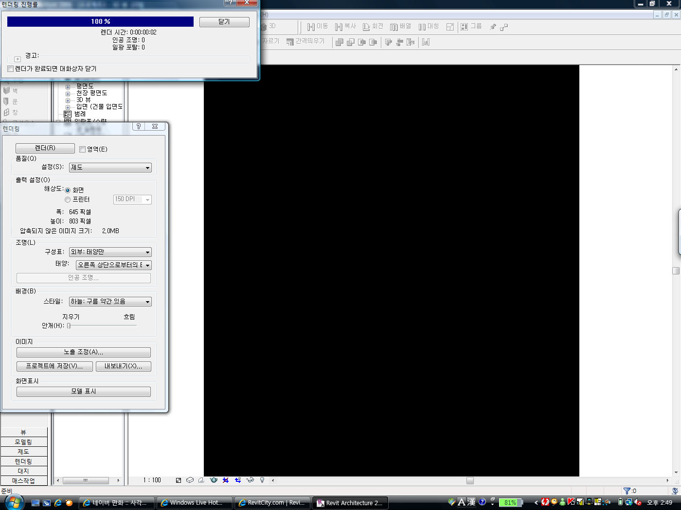

Here is a capture image. I don't think you can read the text. Cause it's Korean Version.
But as you see, the render time is just 2 second, and there is just black color on the screen.
and I set every settings correctly. I used revit 2009 renderer for last project, so I know about the settings enough.

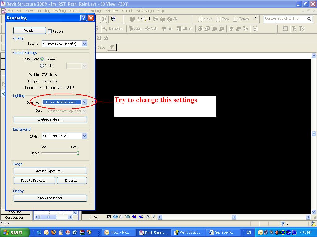

I think I got the solution to your problem, have you checked the lighting scheme, cause when it is set to Interior artificial only it renders & nothing is shown except black screen I have attached an image for your reference.
