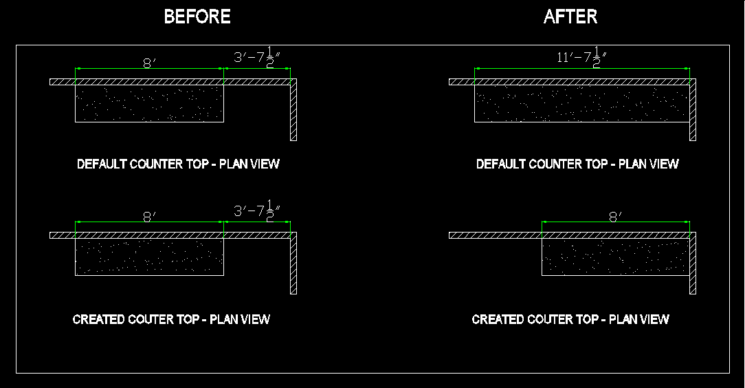

im sure its probably somethign real simple but i cant figure it out. i want my families to be able to be "strecthed" rather than moved when i used the align tool. example: i create a counter top at a default 8' long. so i load it in and turns out the counter top turns out to short. so i try to align its right edge to the wall face that it should extend to and rather than strecthing to the wall face reference alignment it moves and is still the 8' length. one option is to have a "length" parameter so i could input the desired length but what if i dont know the length. also thats a longer process. i tried reverse engineering the defualt counter tops but could not figure it out.

thanks WWHub and coreed but thats not what i was looking for. attached is a little illustraion of what im talkin about. heres another explanation of teh image and my intended question:
the top represents a default counter top from revit and the bottom represents a counter top i created from scratch.
i would like to close the gap between the counter top and the wall face.
one option would be as yall suggested to use the "length" parameter and input the length of the full desired length(8'-0" + length of gap to wall) of the counter through the porperties. another would be to drag the counters right edge via the grip arrow to the wall.
lets assume i dont know the full desired length(8'-0" + length of gap to wall) of the counter and i dont want to click and drag a grip to the wall.
 i want to use the align tool to "stretch" the counter.
using the align tool i selected the wall face as the reference and the counters right edge as the entity. the default counter top "stretched" whereas my created counter top completely moved keeping its original length.
doe sthis make sense?
how do i make my counter top able to be "stretched" rather than moved using the align tool.
hands on exercise if you need to actually see it firsth hand:
in a new project insert the default counter top 24" form the library. draw a detail line out a random distance to the side of the counter. use the align tool select the detail ine as teh reference and select the closest side of the counter top. it stretches that edge to the detail line right?
thats what i want to do. not just for counter tops but for other applications such as piping or possible wall mounted tables or such.

I may be misunderstanding, but the alignment tool WILL stretch a parametric family. If you parameter-dimension to a reference plane and the object edges are locked to it...instead of parameter dimensioning to the object itself...the object stretches when aligned rather than moving when aligned.
Also, once in the project you have to be aligning the reference plane rather than the object edge...both will light up to be selectable, but if you select the object it moves, reference plane it stretches. To make this easier to select, sometimes in the family editor I will draw an oversized reference line and lock it to the reference plane. In the project, it lights up nice and big and the family stretches when you align it. In the family editor be sure you parameter-dimension to the reference plane and align-lock the line to it...parametering to the line doesn't work and locking the plane to the line doesn't work.

thanks bauhaus1919 thats the answer i was looking for. yeah it does stretch. WWHub you should try what bauhaus1919 says to do to see that it does stretch using the align tool.
bauhaus1919, you said to draw a reference line and use that to align, which i did. but after looking at the default counter top in the imperial library i noticed they dont have a reference line. only a reference plane but yet that counter stretches. also i noticed it has a masking region on the top surface.whats a masking region for?
