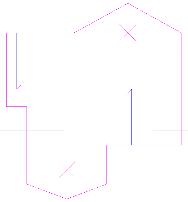

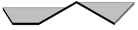

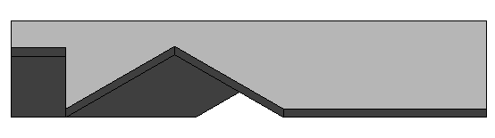

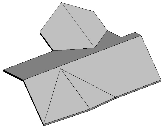

Does anyone have any ideas of how to create this roof?  I've can get the different gables by doing three different roofs, but I'm having a hard time combining them to get the hips and valleys correct.  Is there a way to make one roof with all the correct gables and things?  Thanks!

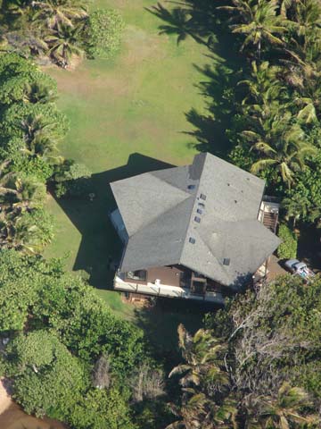

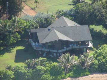

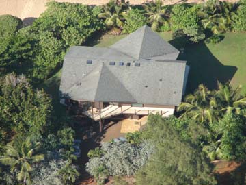

Ok hopefully, these files will attach.  If anyone can help me, I'd really appreciate it.  This roof has one primary gable and then 2 cross gables that go out to a point from an aerial view.  I've tried making one roof.  I've also made 3 separate roofs but haven't figured out how to delete the extra stuff after joining the 3 roof geometries.
Thanks,
Michelle

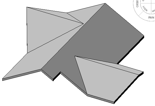

Hi, can you put your model to see what it's wrong?

"to delete the extra stuff" pick in the roof then in TOP menu pick "CUT PLAN PROFILE" and cut what do you want...
See the video: http://screencast.com/t/3kvYFQghdG

Hey I created this roof. See if my pictures match what your after.
