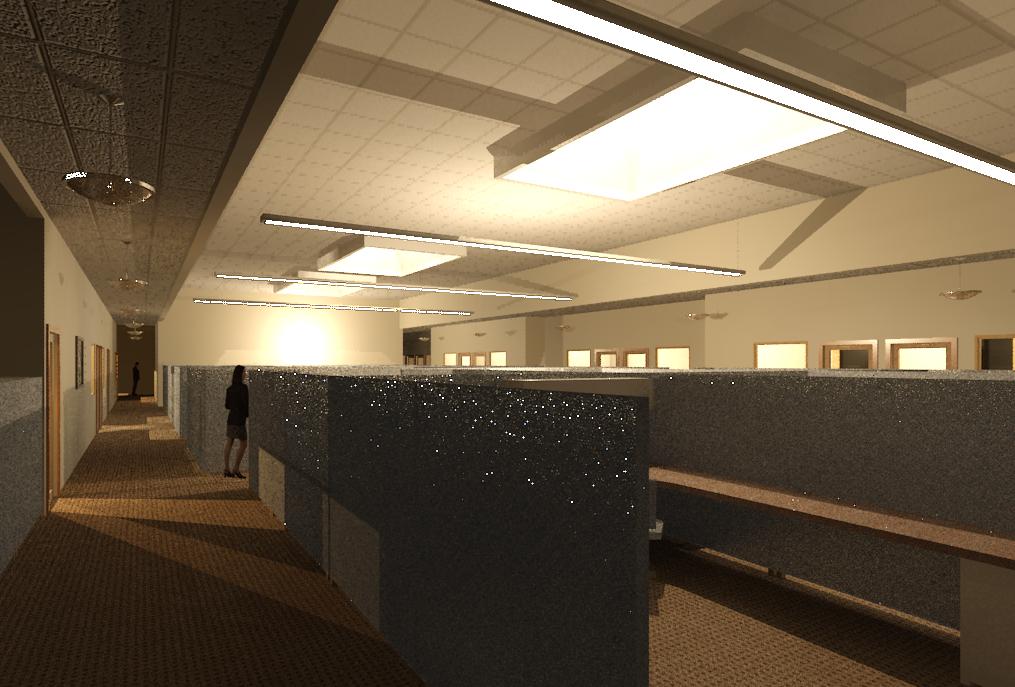

Hello,
I am doing an interior rendering with revit arcitecture 2009 of an office with cubicles. For some reason no matter the Quality of the render I have little white spots all over. Now in other renderings this issue would come up when I had materials that were too reflective but I don't have any materials like that in this render. Any suggestions would be great. Also the pendant lighting I have in the image doesn't bring light to the ground. it just lights up the fixture not the space. I don't seem to have all these issues with smaller residential spaces. Can anyone recommend a good book or somewhere I can get more information?
 -Stephanie

I've heard that using daylight portals may help.
Thus far I've seen that using the settings shown here:
http://forums.augi.com/showthread.php?t=80832&highlight=render+custom+settings+Leo
Work

Check your render material. There is a check box to add flecks. The default color for flecks is white.
