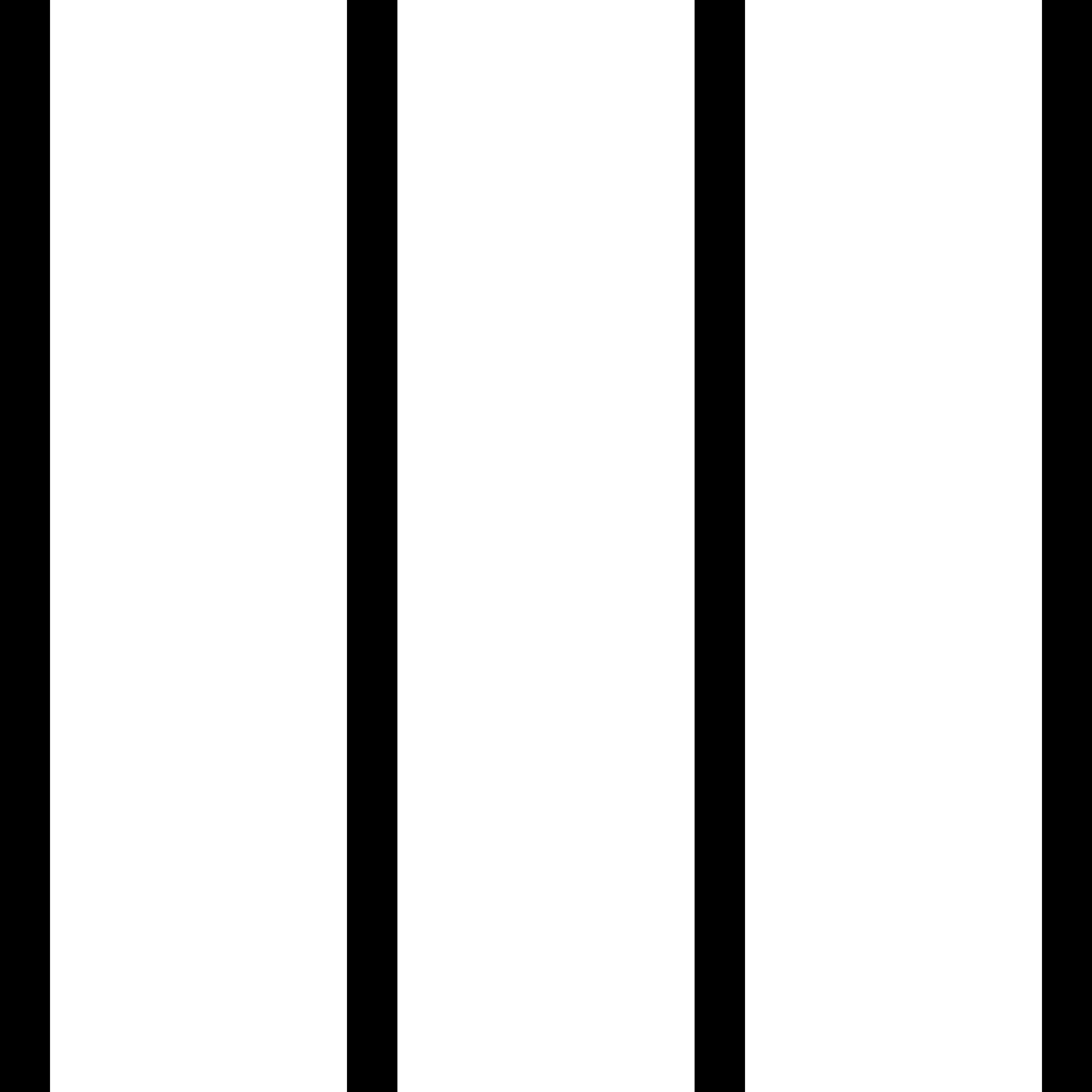

Hey, I have a material where I need some parts to be transparent, and some parts need to be solid colours. Imagine the picture as a stud frame. I need the black parts to look like wood, and I need the white part to be transparent. Could someone please explain to me how I'd do this? Im using RAC2009, so the tutorial in resources doesn't quite help me.

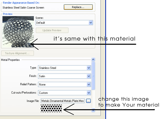

if uses Curtain Wall, it's easy. But U can use material to make it.

DOCCODY has right, i think it's more easy tho assign a material in the element but also you can create a Group-Array to that....
