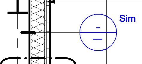

I have a built up wood column in my current project.  In the floor plans I have a plan detail called out.  On the sheet with the plan detail viewport, I also have a section of the column.  On the section I would like to put some sort of callout refering to the plan detail.  This would be sort of like drawing a horizontal section cut.  My first thought is to place a section tag and use the refer to other view option to mark it for the plan detail.  The problem is revit will not let me refer to a plan detail in a section view.
So what is the work around?  At the moment we have a text note calling the column and referring to the plan detail.  I hate doing this because it defeats the purpose of having tags that automatically update.  So now I am stuck with at least one text with leader that I have to monitor incase I move the detail it is referring to.

What I have done in the past when I do this is in the section add a "Section" but have it as a "Detail" vs. "Building Section" or "Wall Section" and I have the section refer to my plan callout.
Tue, Aug 5, 2008 at 3:52:19 PM | plan detail callout in section
Just use a callout, detail that refers to what you want.  Very...very....very small bubble - see attached.

You can create a section from within the section.  I tend to avoid using detail sections in most cases because they have some strange built in visibility limitations.  You must run it vertical first, then rotate it 90°.

As I said, use a callout detail.  This is a section with a callout detail.  The blob at the end of this callout is really the callout bubble.

Thanks that did it. I was having difficulty changing the family category initially. Cheers. kats

With Revit 2013 onwards you could use a view reference tag to do this with the reference other view option.  It can look like whatever you'd like.  I did blog post on it previously:
