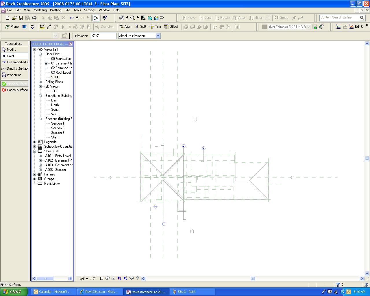

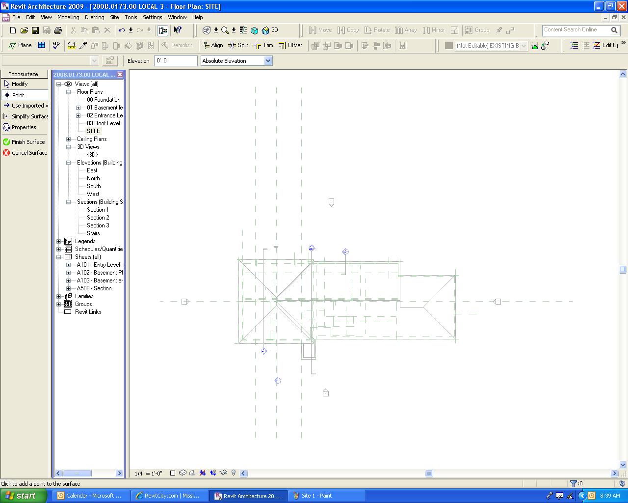

Ok, So I know have a site plan per the responses, however, when I pick my ponts it is generating it way above the house, even though I have my eleveation set at 0'0" (same as my buildings main level).
Any idea as to what might be causeing this?

Hi ggardDLSC, i don't understand what's the problem, can you put some screeshot to figure out what do you need?
see the video:  http://screencast.com/t/eNOv89wMFf

Mhans- excuse my ignorance, but I dont know what you mean by actvate the blue grid (the only blue Im aware of are the floor planes, which are set at -9,0 and 9), or really even the active plane, Could you elaborate?

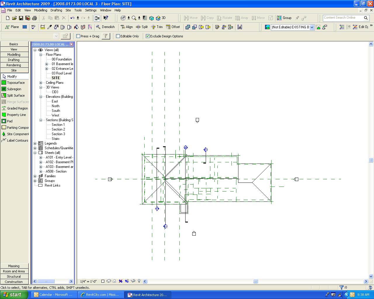

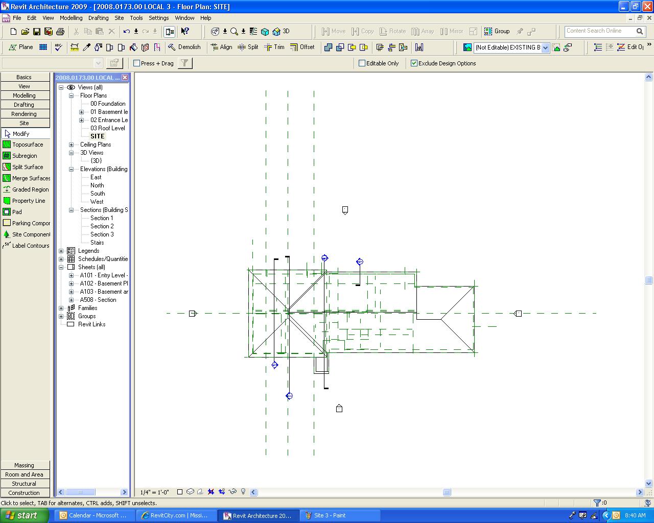

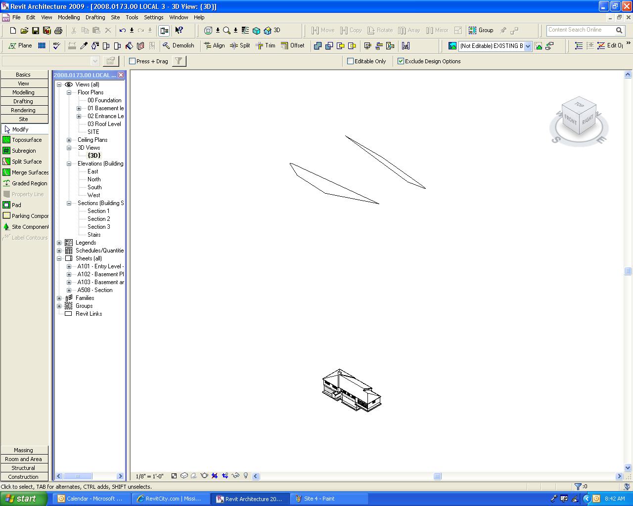

Typhoon- I dont know how to make fancy video screencaptures so I have attached 5 sequecial "photos" first I am in my site plan, then I select topo surface, you will notice that the elvation is 0'0", however, as I pick points none apear. I then finish surface and still nothing appears,THen in 3d you can see my surfaces way above the house.
(this is an existing conditions plan, so if it looks like 1950's suburbia, thats because it is)

Hi GG, to make this "Fancy Video" go: http://www.jingproject.com/ then download for free The JING, it's very easy to use to make photos or Video, about the Site i don't know how do you made  the "SITE PLAN", did you make by my way or the "MHANS" way? just like you did see in the second video (the continuation of the first) i create a site around the "House" with 0-0' but in METRIC, (the units don't matter) but you can check using your units (Feet and Fractional inches) when you are in SITE PLAN-VP-VIEW RANGE-EDIT and check if the "TOP and CUT PLANE" are with this values 328' 1 1/12 and in "BOTTOM and LEVEL" are 0'0'... if you can put the model to download when i go home i take a look on that....
