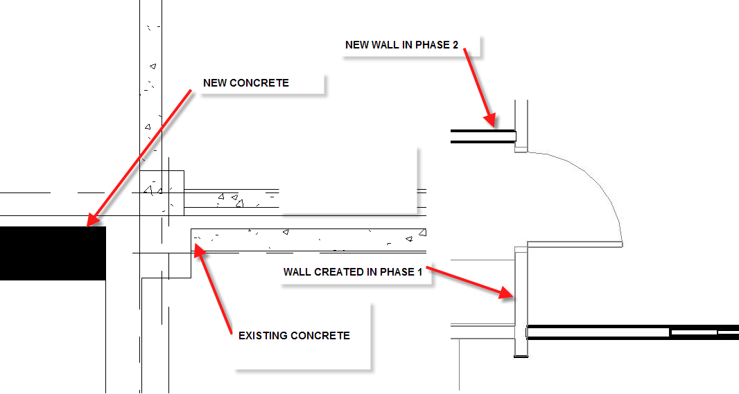

Typically we either have a limit of work or we are only keeping the structure of the building. The method for showing new/ old differs between the 2. When we keep the strucure only I use a solid black hatch for new concrete and a concrete pattern for exsiting walls. When you have a limit of work you can just draw a limit line.
Also elements created on previous phases should show up grayed out in future phases.

We use a lot of 3D images in our construction documents.  The graying out of the existing walls in the new construction sheet really lets them see the new versus old without having to place a lot of notes.  I think Revit has selected the wrong default.  If you copy something, it should also copy the "phase created" too, rather than changing the phase to the sheet phase.  JMVHO.
