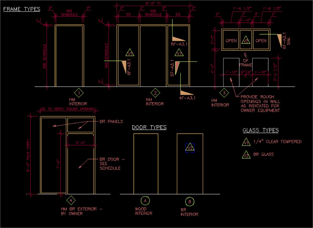

It is standard in our company to produce frame & door type elevation drawings for each type we have in a project. I figured out that you can create a legend with legend components, such as front elevations of specific doors in the project. But my question is how do you dimension to the legend components since it doesn't recongize the snaps. Am I on the right track or totally offbase? Attached is an example of one of our AutoCAD produced Frame/Door type drawings. I am trying to produce something very similar. Thanks
Wed, Apr 6, 2005 at 6:07:22 PM | RE: Frame & Door Type Elevation Drawing
TomDorner
Joined: Sun, Apr 25, 2004
1207 Posts
4.5 Stars: 25 Votes
It is kind of anti-Revit like, but we just simply use a drafting view to do the door and frame type elevations. Once it is done once in a project, you can group it and save the group out to a network location to be inserted and modified in the next project. Tom
Wed, Apr 6, 2005 at 6:26:18 PM | RE: Frame & Door Type Elevation Drawing
Mr Spot
Mr Spot Avatar
Joined: Mon, Jan 12, 2004
2889 Posts
4.5 Stars: 93 Votes
Pre V7 we would create elevations of all the different types of aluminium doors and windows for a our visual schedule. V7 we woud use the legend component and draw detail lines over the components in order to dimension etc because of the no-snapping issue. (i understand this will be fixed in the next release...) We prefer these methods as to using drafting views as they will be updated if the family is reloaded and updated or a type changes size. HTH.

One other small question, we only show different types of frame and doors and not all sizes. We normally edit the text of a dimension to read "See schedule" for the widths and heights. How do I override the text of a dimension? See attached image for example from the orginial post. Thanks
Thu, Apr 7, 2005 at 10:57:46 AM | RE: Frame & Door Type Elevation Drawing
TomDorner
1207 Posts
4.5 Stars: 25 Votes
You cannot "override" dimensions in Revit. What we do is place text with an opaque background over the dimension text that reads "see schedule". I've attached our Revit groups for you to insert and take a look at. Tom

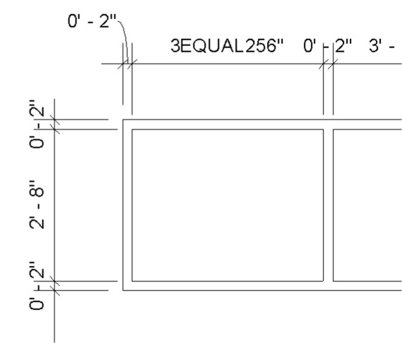

The opaque background text works fine if the text is longer than the dimension behind it. What if the dimension is longer than the text? We tried stretching the text box but it only blocks out behind the text. We also tried appling a opaque filled region but it stays behind the dimension and not if front of. Any other ideas on how to get the dimension "blanked out"? See attached file for example. Thanks again!
Thu, Apr 14, 2005 at 12:19:05 PM | RE: Frame & Door Type Elevation Drawing
TomDorner
1207 Posts
4.5 Stars: 25 Votes
A couple of ideas: 1. Try adding "spaces" in front of and after the text "see schedule" set to centered paragraph style. 2. Place white filled region over the dimension with the text on top of region. 3. Create annotation family of a filled region and "see schedule" text. HTH Tom
