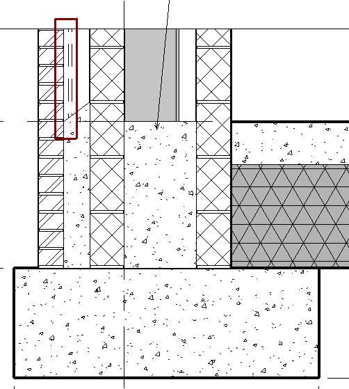

Is there way of making a cavity wall so that the cavity isnt filled with anything?  I have a cavity wall and in it partially sits a colimn web and flange.  Now when I do a section it shows the flange as hidden, even if I sat the cavity as an air barrier?
Anyone got anyideas?

Attached now , the riinged item is my flange of my column, it should be solid and also grey!
Using RS 09 Smile
Thanks for the help

Hi again, do you sure that zone is a "Air Barrier" and you don't put some hatch or material when you create that wall?
Is there a Section View only or a Callout View? you can solve that by going to Drafting and create a Masking Region with "invisible Lines" under that Hidden Lines...

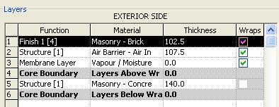

The Construction of the wall is attached.  The Air Barrier has no fill pattern for the cut.
I have just used the stylus too for now and changed the lines to thin.  The detail is in section by the way.

Hi MARTIN, when i use Air Barrier in "Function" i put "Thermal Air Layer" and not "Structure [1]" but this not change the problem, you must have some material or pattern in "Cut" in the material "Air Barrier", do you have "None" in Cut Pattern"? check this...
