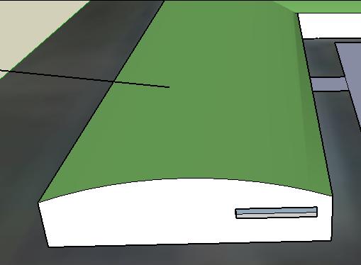

Hi,
Can anyone tell me how to make a curvy roof in revit 2008. here is the attached image
Thu, Jun 12, 2008 at 8:23:10 AM | Curvy roof
In your help menu under roof - look at roof by extrusion.

Thanks! i made it exactly shown in the image.
