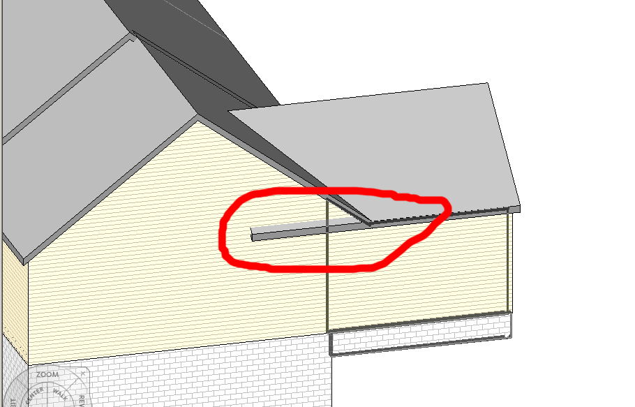

I have a gable roof that I want to extend into another gable roof, but I keep having the problem shown when I join the 2 roofs. Any ideas?

Do a single roof footprint intead of joining them. It automatically makes it's own valley. Then you can just play with the slopes.
