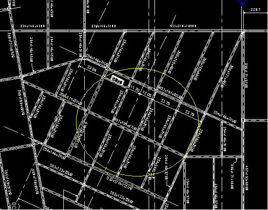

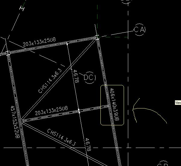

Please see the attached image and tag family
Due to the orintation of the title sheet, I want to rotate the highlighted tag 180 degrees (upside down) which means when it is printed it would look the right way up.
Unfortunetly when ever I try and do this, either in the drawing sheet, the view or the family its self it simply does not rotate. Its remains the wrong way up.
I think Revit is trying to keep the text orintated to the project north or something like that, but its an assistance to far in this case.
Has anybody ever experienced this and do this know how to disable it or work around it?
Thank you as always for any assistance.

Hi thank you for your help.
I did what you said and found the parameter you are talking about but it made no difference. I am still unable to rotate the tags.
I also tried going into Family Category and Parameters and disabled "Rotate with component" however all that does is make all the text horizontal on the sheet and I still can't rotate it regardless of the "Make readable" parameter been set on the tag or not.
Is it because its a framing tag?

@ Martin - thank you but I am already using my own tag. I'm not sure of any parameters that I can use to solve the problem.
 @ WWHub - If I rotate the sheet unfortunetly some to the text will remain orintated incorrectly.  Please see attached screen cap.
 Thank you.
