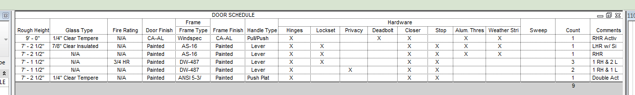

I'm reopening this thread since I have somewhat similar question.
How do I add a parameter that could go under the 'Hardware' heading? I want to add a column for Door Sweep along with all the other hardware items? Any advice?
Mon, May 2, 2011 at 10:03:54 AM | Door schedule manipulation...
DeifyMe
Joined: Thu, Oct 7, 2010
64 Posts
4 Stars: 2 Votes
My apologies for posting this, I figured out the simple solution. I was working off an old project so I wasn't sure how the schedule was created. The parameters were all grouped and given a heading. All I had to do was ungroup them and then regroup them including the new column.
