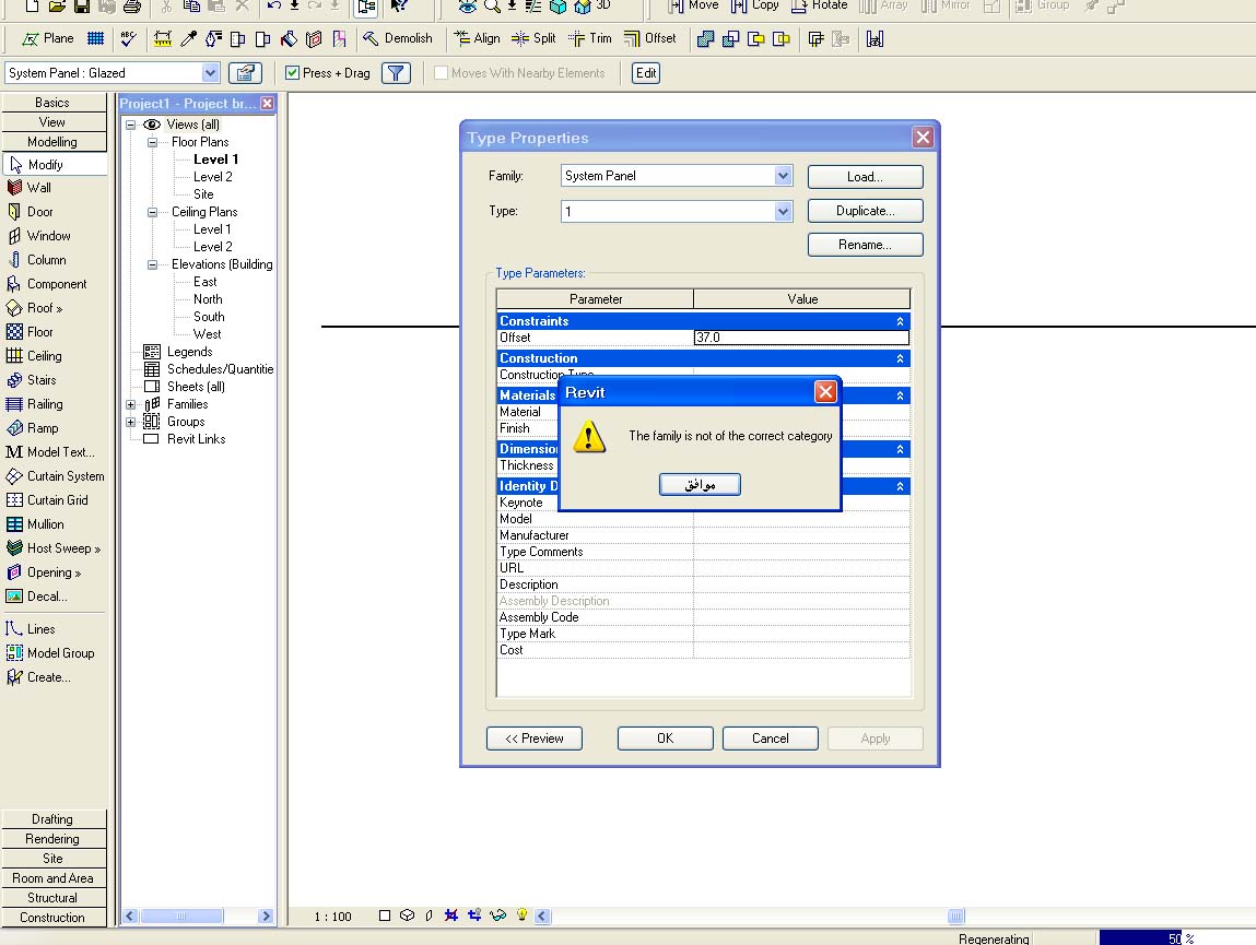

Fri, Jun 6, 2008 at 1:07:18 AM | Doors and curtain wall
bhobho
Joined: Tue, Jan 4, 2005
42 Posts
5 Stars: 1 Votes
I have tried but did not succeed
I hope to find help for this problem...plz..
see attached
Fri, Jun 6, 2008 at 1:21:26 AM | Doors and curtain wall
Mr Spot
Mr Spot Avatar
Joined: Mon, Jan 12, 2004
2889 Posts
4.5 Stars: 93 Votes
This is a FAQ.  Check out my blog for my answers to similar type questions.  But you must first load a curtain wall door (they are special types of doors and are do not come in under the door option)  tab select the curtain panel,  Now hit the type selector drop down and you will see your curtain wall door in this list.  Simply select it and thats it.
Alternatively, you can tab select the panel, then go to the type selector and select a " basic wall" type.  Now you can place a standard door in this wall like normal...
