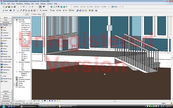

hi there. is there any way of removing the space below the stairs and a ramp cause i can't figure out how,  here are some pics

What do you mean by removing?  Do you mean to infill with supporting walls?  Which sort of explains what you need to do.  With the Ramp and you can change it to mass concrete instead of a constant thickness in its properties...

sorry for the misunderstanding, yeah i meant to fill the space below the floor, ramp and stairs that i made, i was thinking of creating a mass but i have 4 stairs n ramp of that kind so maybe there is a different option of doing it, thanks for the reply mr. spot
