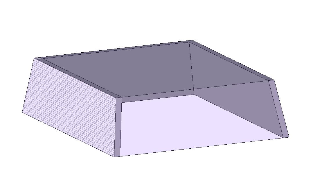

Thu, May 29, 2008 at 3:08:45 PM | DOES ANYONE KNOW HOW TO MAKE A SLOPED WALL IN REVIT 2008
mhans
Joined: Tue, Nov 7, 2006
456 Posts
3 Stars: 10 Votes
Can you upload the .rfa? Nice! Here's a simple shot of a sloped wall. Use Massing and Wall by face.

Thu, May 29, 2008 at 4:00:43 PM | DOES ANYONE KNOW HOW TO MAKE A SLOPED WALL IN REVIT 2008
Joined: Tue, May 22, 2007
5921 Posts
4 Stars: 205 Votes
Hi MHANS, why do you want the .Rfa? it's so simple to do it...
