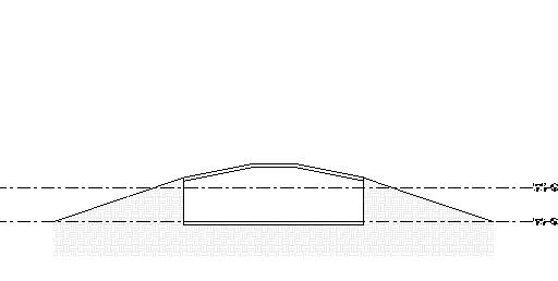

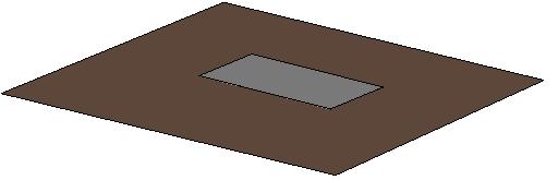

I am trying to create a bunker or and earth covered building. I've tried multiple ways.  The best way so far was to create a pad and a topo w/ it's top elevation mark at the roof elevation of the covered building.  Then I came back in w/ a second topo starting @ that roof elevation height and finished the mound. Everything looks good until I take a section cut throught the building, in which I have the earth hatch pattern.  Is it as simple as creating (2) different earth materials (1) w/ a hatch and (1) with out the hatch?
What 's the best way to create this?

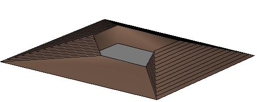

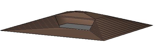

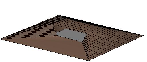

These are the steps that I took.
Step 1 was to make a topo surface and add a pad
Step 2 was to increase my elevation points around the pad on 3 sides to = my roof height
Step 3 I added a new topo surface on top, starting @ the roof height, and finishing @ top of mound.
Result: In section the earth hatch pattern goes through the building.
I've recently tried taking Step 3 and making it a floor w/ materials that match the site instead of another topo surface, and it look correctly in 3d as well as section. It has no hatch in section, but I guess I'm better off that doing that and add in my own fill pattern.

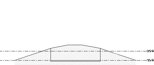

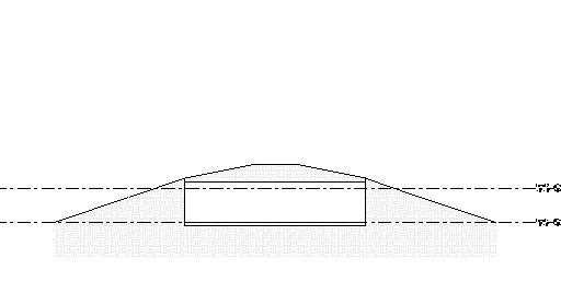

This was the quick fix that I did...
It's similar to the suggestions that R7oky and Typhoon made:
Removed the 2nd topo, made it a floor, and changed the properties to be a variable height. Then just adjusted the floor's properties to have the earth fill pattern.
The 3rd picture is how it turned out.
I think it will look close enough, the client won't know the difference.
Thanks everyone for the help and suggestions.
