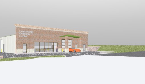

In the last couple of rederings that I have done, THere has been this grey surface that has emerged on my topo and model. I have no clue what it is. It looks like it could be a ground plane, but upon further inspection it's not. See if someone can help. Thanks.

Sorry i can't spot what you're referring to as i'm not sure what its suppose to look like. If you highlight the anomaly could be a little easier?

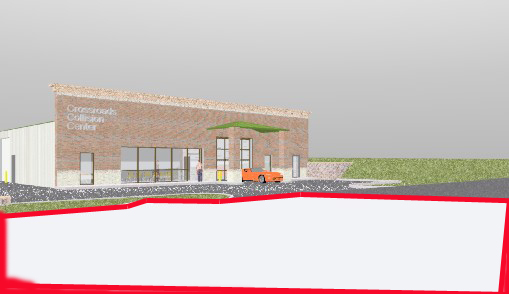

Mr. Spot, The area highlighted in red. That is the surface that I am talking about. Thanks in advance.

OIC, Really obvious when you know what your looking at. This surface doesn't show in your shaded/hidden line views? If not then it will be something to do with the rendering settings? you mention its not a ground plane? Is ground plane turned off in Rendering Settings-->Environment? and Advanced Model Graphics/Sun and Shading settings? The only thing i can think of is the actual camera setup/clipping... HTH.

No I have turned the ground plan off, I didn't think it could be the camera, seeing how it had not done this before up unitl now, I checked all the camera settings dropped even new cameras, and it's consistant, that grey whatever is still there. I will have to keep on trying. Thanks.

i think i'm having the same problem with the mystery surface. i think mine is the ground plane which i can't seem to turn off. everytime i uncheck it under render settings - enviroment, its checked again when i go back......... is there another place to uncheck that box? please help.........please. thanks

There are two settings for ground plane - Refer my second post in this thread.

yep...... the ground plane was turned under advanced model graphics. i guess i didn't realize you have to turn on cast shadows to reach that option. thanks.
