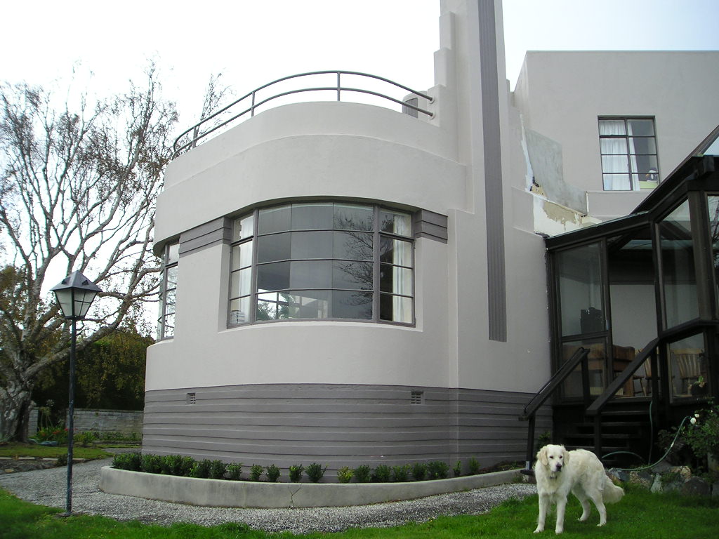

I am currently trying to make a curved window which will fit to a curved wall, it is doing my head in at the moment and I was hoping someone out there has done one of these before.  I have atached a photo showing the window in question

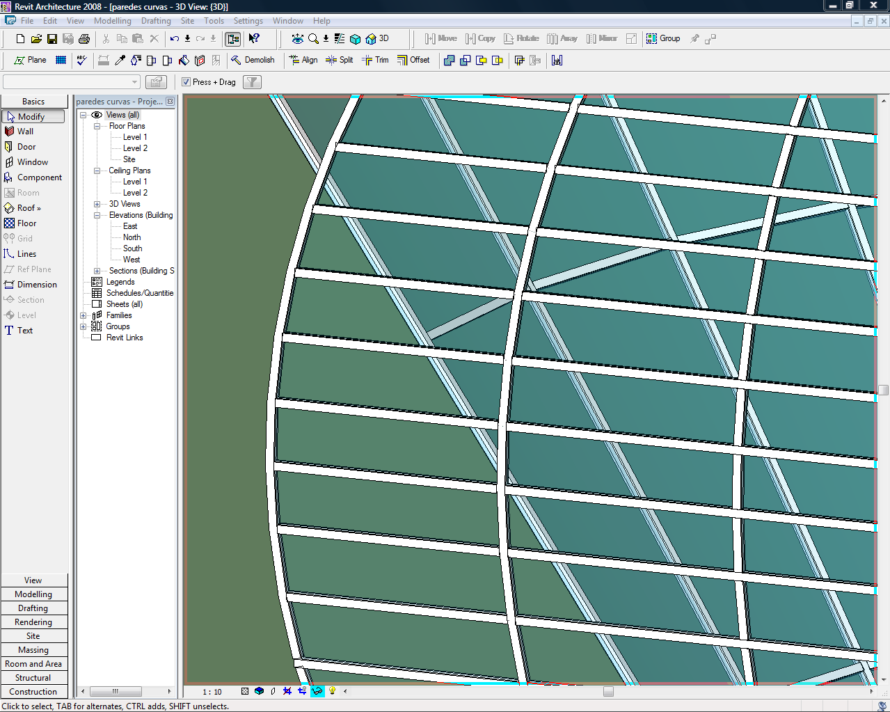

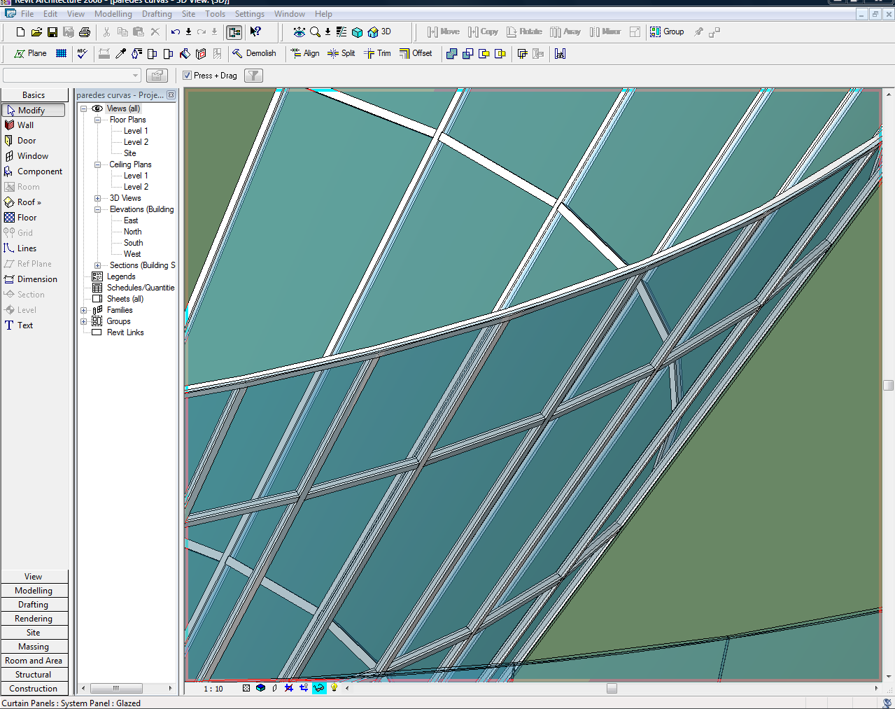

Hi SAM, until now i don't see any round window made by anyone in anywere but you can do this with "Curtain Wall", it's very simple to do this (image attached)... and more quick...

 Don't use curtain walls for this, as the Mullions will be jagged...unless someone knows a fix to that?

Yeah, TABEST it's right, that's a solution too, i don't understand what means "the Mullions will be jagged"....???

We had a curved window and each mullion join had it's edge sticking out... like trying to make a smooth circle out of bricks.  I couldn't tell by your pictures, but do the mullions themselves curve?  Or are they straight?

the mullions are straight... just like the glass... if you look the Photo from "Sammyr" there are straight too...

I think by "jagged" he means the jaggies that appear on the mullions in design view. That will fix itself when you render.
