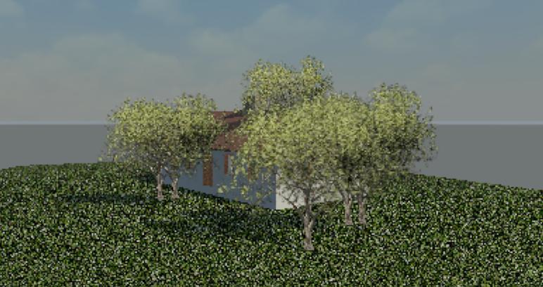

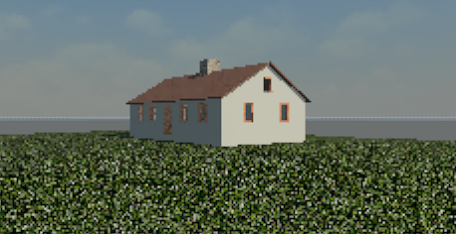

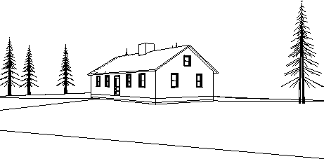

Hello Typhoon
I'm working with the newest version Revit Architecture 2009...I have it with most plants and to give yuo an idea of the situation, I will add 2 pictures of a tutorial drawing.  The settings of the render where "draft", Lighting--> exterior sun only..
Hope that's enough info...

Right now i don't have here Revit 2009 but i think this tree it's from 2008, try insert a tree by RPC component, there are M-RPC...(male, female, shrubs, trees...), there are a folder in revit 2009 with RPC, then you can change your tree with properties, name, heigh, type and so one. When i open an old project in Revit 2009 the trees in that model appears just like your model in 3d-view but when i do  the render thei dissapears so... try to do this.
Send me a feedback..
Good luck

Yes finally it worked...thanks a lot...
I always used the simplistic plant familie from the library, though never used the RPC component. This looks so much better..
