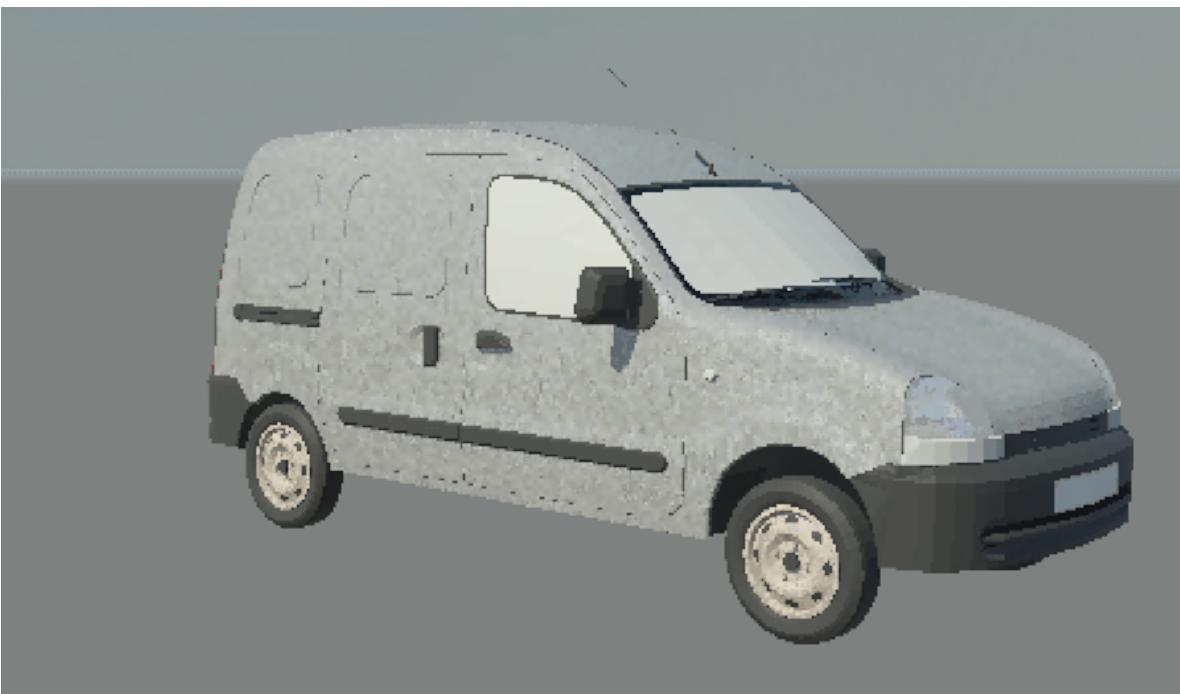

I'm working with Revit Architecture 2009 and at the moment I'm starting to render my images I notice that objectes like car's dont have materials set and become complete grey (default color). I've tried to open several car's in the editor and changed the render appearance materials, but every time I try to render my images I don't really notice any difference. Btw I don't really know what materials I have to change as they don't really mention what their assigned to, so I've changed them all to something new.
Does anyone know what I forget to do?

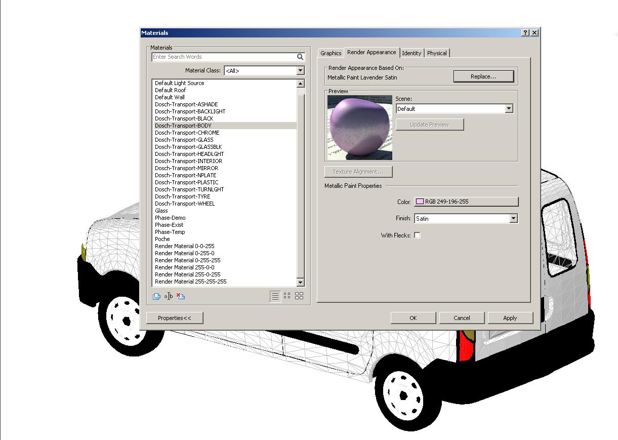

Hi there, the cars are made in other programs like Autocad, Inventor, Rhino and so one, they use  materials from "Accurender", Revit 2009 don't assume that materials just like that (in RAC2008 there's no problem because in there we can tell "PATH" where are Accurender materials install) but when you import a car to your model go to SETTINGS-MATERIALS and you can see there are new materials in the scene, (i.e. appears materials like "RENDER 205.147.145"....) this is the materials from your imported car, try to change one of this materials and render to see what change...

I've changed every value in the familie editor, including those render 205.250. etc materials, but still nothing changes..
I've changed the values outside the familie editor aswell, but that didn't do a thing either.
I guess there's something wrong with my install then.....well thanks for you awnser anyway.
I've included 2 attachements.

Hi, in the image below, the only think isn't render is the glass, change and render...
