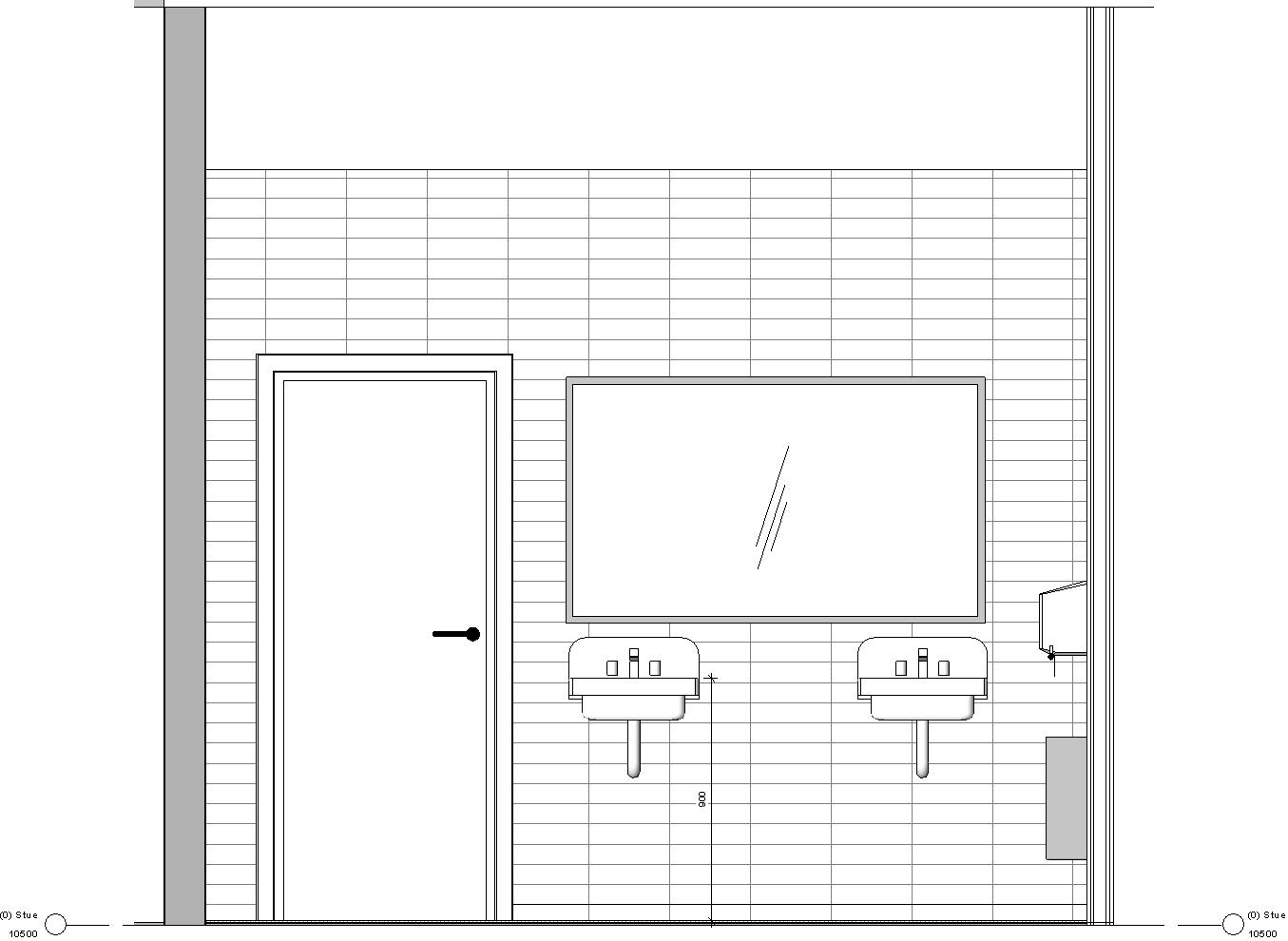

Im making a interior elevation plan. Then i have used paint to show that i have tiles. But it doesnt make the right endings. See attached pic. How do i change this?

u can use the align tool to move face materials

Wont i move the wall then?

nope,
select align select the edg of the wall that is in section and select a vertical lign of your tiles,

youre right thx!!
What does this mean?
 The closed loop used to split the face must lie completely within the face and cannot intersect or overlap any of the face's edges.  To split a face at its border, use an open loop that ends on the boundary of the face.

You get this message when you use the split face tool. It is telling you that you have drawn a closed area and its boundary is either touching or overhanging the wall edge. You will need to do one of two things; either draw the boundary entirely inside the wall extents without touching the edge or remove some lines to make the endpoints of sketch lines touch the extent edges of the wall.
