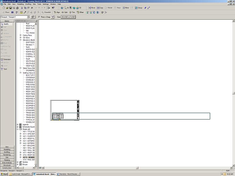

Hopefully somebody can help me with this. We all know that revit automatically determines the size of viewports based on the size of the actual referenced view. Well, apparently, my revit sees the need to include in this referenced view extents that are hidden because they are not shown in my crop region. While this really doesnt affect the final appearance, its really annoying because ZOOM ALL takes you way out of the view and your crop region (the only thing you want to see anyway) becomes way tiny. Anybody else have this problem? Please help! attached is a "print screen" of whats happening....

This is caused by curtain wall grids. Turn these off in this view and it will fix the issue. Also, if you install the latest build this should be fixed all together. HTH.

We have the same problem, and it isn't caused by the curtain wall grids.
we have the latest build 20080101
How do we solve the problem??
