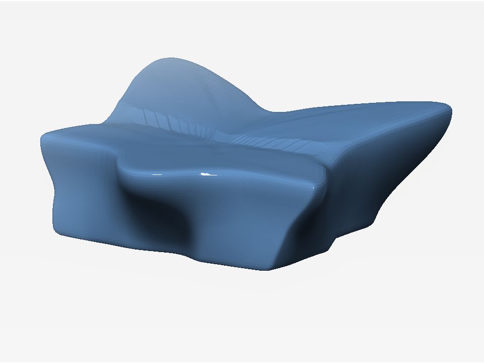

hi i would first like to ask if its possible to follow a curved line in order to make a wall from it instead of approximately redoing all the lame curving walls yourself which never amounts to anything good. I am working on a model and im losing my mind why revit wont let me manipulate families in multiple dimensions. for instanse i want to make a strange shaped curved wall  which has a curve horizontally and vertically why wont revit let me manipulate it in multiple dimensions , its aggravating. is revit only supposed to work for cubic forms or do you need to trick the software into letting it do what you want. Hasnt revit been here for a long while why dont people adress this unnatural way of manipulating families, many questions are still unanswered and the software is quite strange but bim is the future so we try to function with it.  thanks beforehand and here is the model im trying to replicate in revit its really really hard in revit  please help. how do i produce such walls  without making dead mass objects. thanks

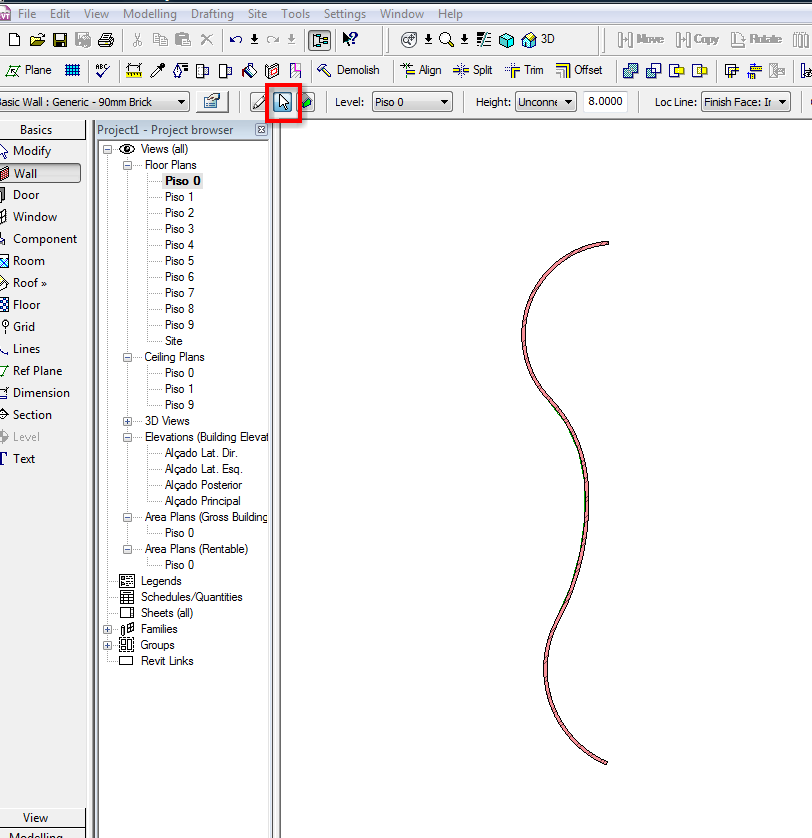

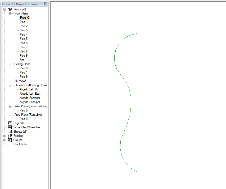

Hi, Revit follow the line to create your walls, but in that case you must using "Massing" and create "Wall by Face" to Revit can "Draw" the wall in horizontal and vertical... it's a funny shape..
