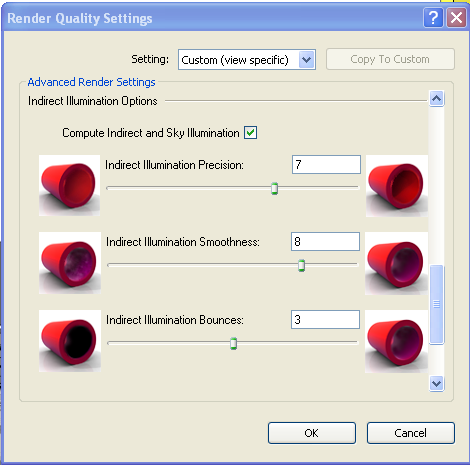

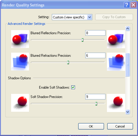

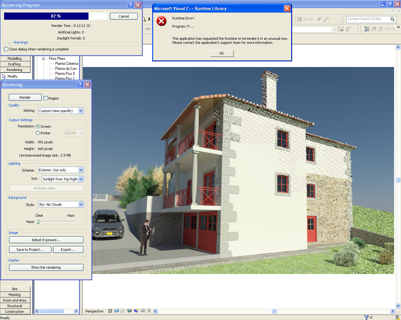

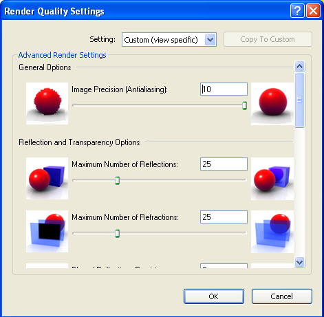

When i try to "Push" for Mental Ray with "custom-Settings" in High appears this Error, anybody knows why? Out-of-memory? what?
Mon, May 12, 2008 at 1:35:13 PM | Error in RAC 2009-RENDER
Joined: Tue, May 22, 2007
5921 Posts
4 Stars: 205 Votes
I have a Dual-Core2 2.4Ghz with 3Gb Ram, ATI Radeon 1600 512Mb XP professional, the settings of render are attached in this 3 images, i push to revit to see the best quality but...

if you dont have the 3 gb switch enabled Revit can only utilize 2 gb of your ram. the autodesk website support center gives you detailed instruction on how to enable it.

Hi "MikeM" thanks for advise, but it's to late, i do that but XP don't recognize the 3Gb, i ask for my " hardware supplier" and he told me it maybe the new drivers from "Chipset" so i go to Asus site and actualise the drivers, but XP don't LIKE so i "Crash", my solution was install Vista 64Bits, backup all my folders format the disk and them i install the new drivers from "Chipset" to my motherboard... now i work with Vista 64 and i don't have no more that problem... i "push" from Revit mental ray and it's ok...
