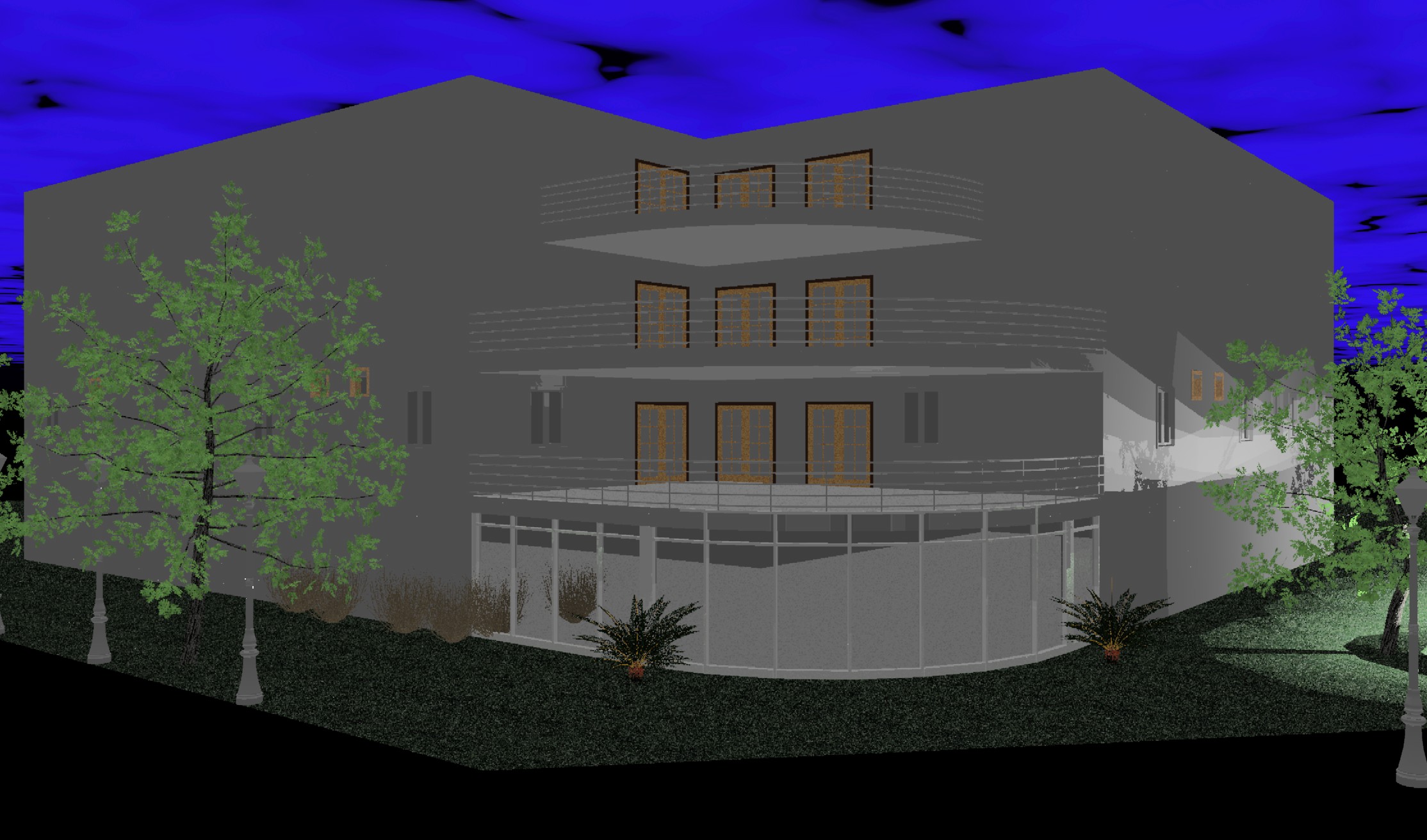

Hi!
Is it possible to hange that grey color?
How? can you give a link to a tutorial?
I want to change the gray of these walls

Hi, this is not a RENDER? is it?
First of all, when you create your wall type you have the choise to choose the color in "Model" , pattern in "Cut..." and "Texture.." to Render, so, if you do that, the image in attached it's Ok, isn'it?
I don't no what version of Revit are you work, (are the same equals, more or less),  but when you create (in this case) wall you must do that (color, cut and texture...) then when you put to Render the color and Texture of your model come "Right", i think you must review the materials of your walls (windows and so one) before render.

That image is indeed a Render.
I'm very noob! all know of Revit I learned it thanks to some video tutorials I found in Spanish. It's a bit hard for me to understand spoken english.
Now, with those new concepts you gave I'll keep on researching.

Soy Argentino. Yo sé inglés, bastante. Sólo que no soy muy bueno entendiendo el inglés hablado, pero sí el escrito.
POr suerte ya pude resolver el problema. Tuve que reinstalar el Revit. Ahora sí aparecen los materiales.
I'm Argentine. I know quite a lot of English but I'm not so good at listienig comprehension, but I am at written.
Luckily, I could solve the problem but I had to re-install Revit. Now I can see the Materials.
