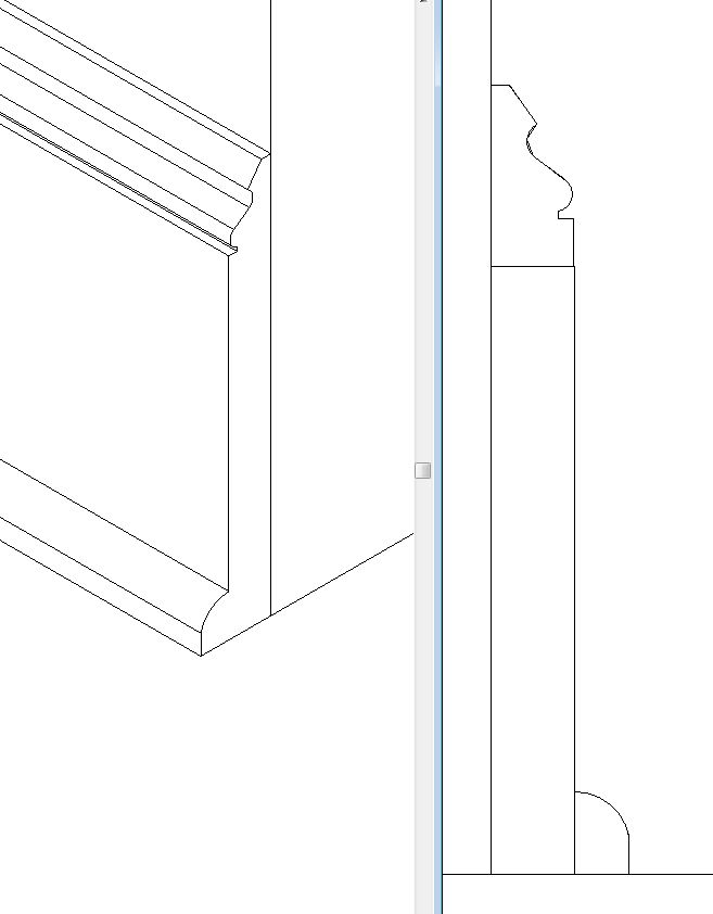

WWHub is correct, there are no multiple elements...BUT  you CAN use detail components in your sweeps, so if you made a detail component for each part of your cornice, and imported them into your profile, put them together, then drew a closed loop around the outside, you will see the elements when you cut a section.  I have not looked into this enough yet to know if you can make the hatch show or not.  I attached an image of what a base moulding wall sweep might look like.  I did this quickly with standard detail components from the Revit library, so PLEASE don;t critique my architectural capabilities!  Winking
Cheers.  HTH.
