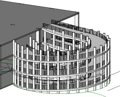

How to trim column using another object? In that case (see pic) I can't make workplane on ramp. Any suggestions?

Columns cannot be trimmed by any non perpendicular plane... You would either need to invidually adjust each column to go to the underside of the ramp... OR Create a new column which has a void built into the family to cut the top with an instance adjustable angle...

Thank's for info. In mechanical application we can find "Extrude up to .." So I have to wait for another Revit Smile
