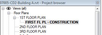

 Here is what I'm trying to do.
 I have my plans.  That have lots of context and are quite large. I made a new sheet and placed a plan on it.  At 1/8", my plot scale, the plans with context run over my title block.  I want to crop the view so that JUST my building is showing.  I realize I can do this by opening the plan model and using the crop region, but I *don't want to change the model.*
I want to resize the viewport (revit calls them viewports btw...) so that the context does not show up.  It would be equivalent to placing a plan on an autocad viewport then resizing the viewport to fit the sheet.  ie the 'xref' doesn't change, the 'viewport' is resized to crop what its showing.   Does that make sense?
When on the sheet, I can turning on the crop region for the viewport (not the model) and I get a button that lets me explicitly, with numerical input, resize the viewport.  I can't get revit to give me handles for the viewport when in a sheet view.
Does that make sense?  Any help appreciated!

I played with this for a while and spoken to a revit instructor, and what it comes down to is that there is no revit equivalent to the AutoCAD viewport which can crop and adjust scale.  You must make a new plan for every scale, every crop, etc.  People (see above) tend to get grumpy when you bring up autocad features to cross examining revit, but it is not really clear what's gained by not allowing cropping and scale changes on the sheet level.
Regardless the workaround is not very difficult: duplicate plan or whatever drawing you need to crop/scale and place the new one on a sheet.  On the other, it is annoying and can start to clutter the project browser.

I am pretty sure I understand what you are trying to do.  Were I in the same position, I would duplicate the view AS DEPENDENT.  By doing this, it is an exact duplicate of the plan view, including all detail lines and components.   However, you cna change the crop region independently.  So I would have the first floor plan be the "working" drawing (like working in Modelspace), but the dependent view would be the viewport, with the narrower crop region.  As you will only use this for your plot sheet, you can minimize the dependent view to reduce clutter in the project browser, as a dependent view is one branch below the main view.  HTH
