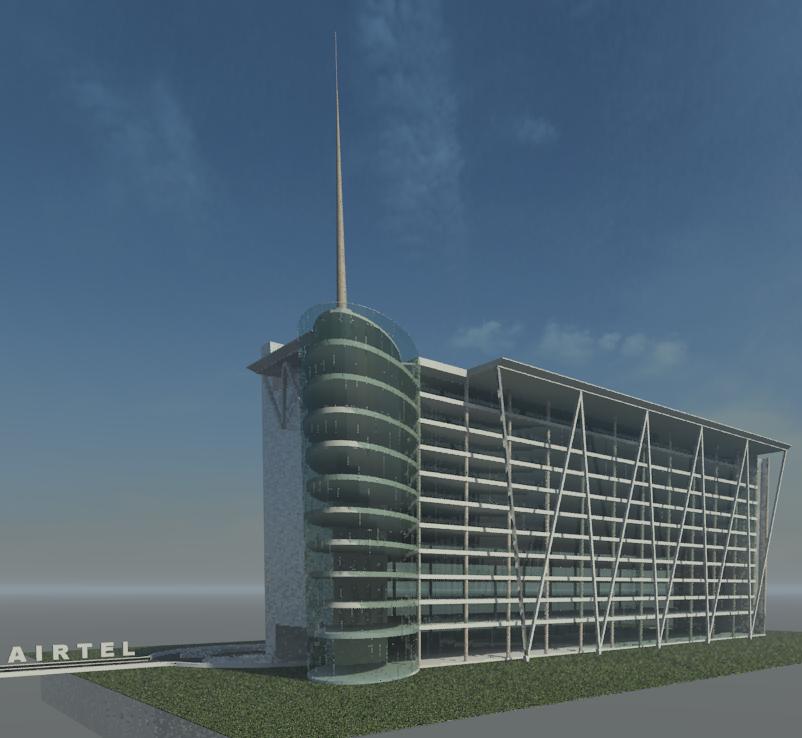

Hi just started playing with Revit 2009 although been using 2008 previously. I placed artifical light and tried to render night view. I tried with all the options in rendering dialog box but I am not geting any result. I have attached an image for which I want to make night View. Please help.

I have been having the same problems with rendering night scenes for both interior and exterior spaces. I think there is some kind of bug in the system that overcompensates for natural light (natural light is much stronger than artificial). So when natural light is on it simply washes out the artificial lights in the scene. The best luck I have had is to manually adjust the exposure settings once the rendering is finished. It doesn't do much, and it can be a pain in the curse - but if you work at it you can get  some results which may work for you. Hope this helps. And if anyone figures out a better way to deal with this please pass it on.
