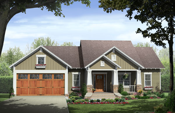

It is a basic hip roof with gabled ends.  The center roof is higher than the garage and the bedrooms on the right and left sides.  The front porch has two levels of roofing on the center roof in the front.  This house is from TheHouseDesigners.com, the particular house is the Wilson Creek House considered a traditional cottage design.  After struggling I actually deleted the roof completely.  Then I had no roof section level at all.  I tried duplicating the floor plan with no luck.   I did find something that said to add a second level where the roof should be and create views and levels for each height difference.  I am not sure this will give me what I need.  I also went back and cleaned up my files by deleting extra stuff without realizing what I might be loosing or gaining.  I seem to be at a point where it might be easier to start from scratch again.
Tue, Oct 20, 2009 at 3:27:50 PM | Roofing Gurus Please Help
Wolfmann16
Joined: Tue, Sep 25, 2007
38 Posts
If it is indeed like the one attached, I would build it as a in-place mass - extrusion or sweep, which ever you are more confortable with.  It looks like, to me, you good do the 'L' portion as one sweep then extrude the entry.  I kinda suck at the roof tool, so i usually just mass it, then make it a roof by face.
