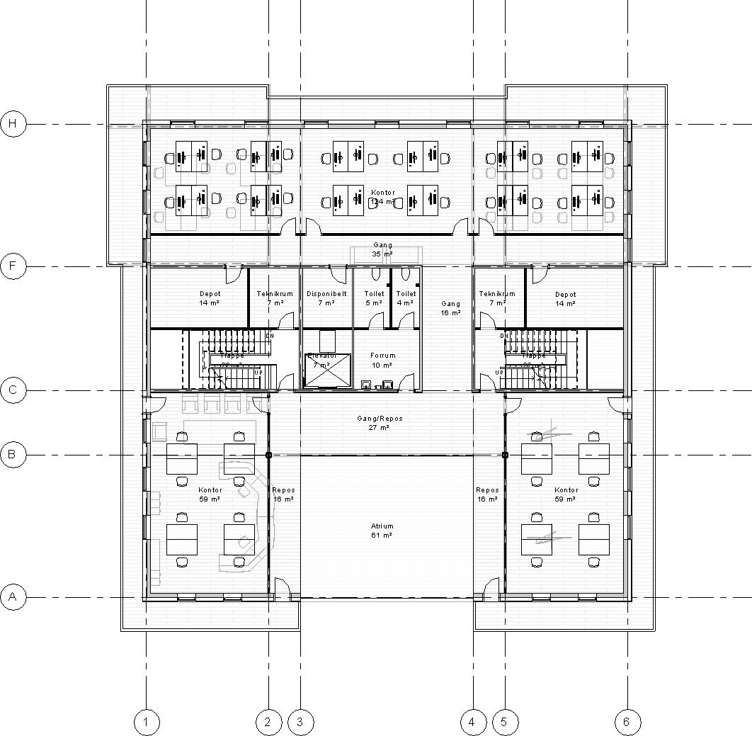

Hi all. Im having some problems with my cutplane. It is on my 1. story view where i can see the furniture i placed on the lower level.  But my cutplane is: Top = 2300 and Cutplane  = 1200. The others are 0. So why do i see the furniture in the lower levels?
See attached pic

Go to Vew Properties and turn the Underlay Parameter to None.
