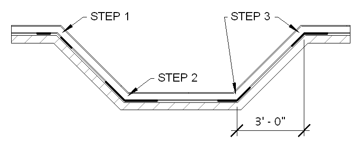

I know it shouldn’t be this hard to figure out how to place the linear dimension on a non-orthogonal wall. I have been trying different options but it just doesn’t let me do it. Or error window pops up saying, “The References of the highlighted Dimension are no longer parallel.” Need help.  Thank you.

I am assuming you are talking about an angled wall such as a bay area; if so, I have found the easiest "work around" to be using detail lines, from the drafting tab, and then using your linear dimension to complete your task.  Refer to the attached image:  Step 1-Using the thinnest line setting, draw short line segments along the wall where you are going to dimension.  Step 2-Using the Trim/Extend tool, fillet these lines to create an intersection.  Step 3-Dimension your wall using a LINEAR dimension.

Forgot to add this little piece of information.  Do not erase the short detail lines; with them set at the thinnest setting, they will not show up when you print.  If you erase them, your dimension will have nothing to reference.

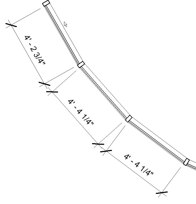

i am talking about dimensioning this kind of curved curtain wall.
Tue, Apr 15, 2008 at 3:30:03 PM | Dimension
Dimensioned according to my last post.  If you want something else ... you can figure it out from there.
