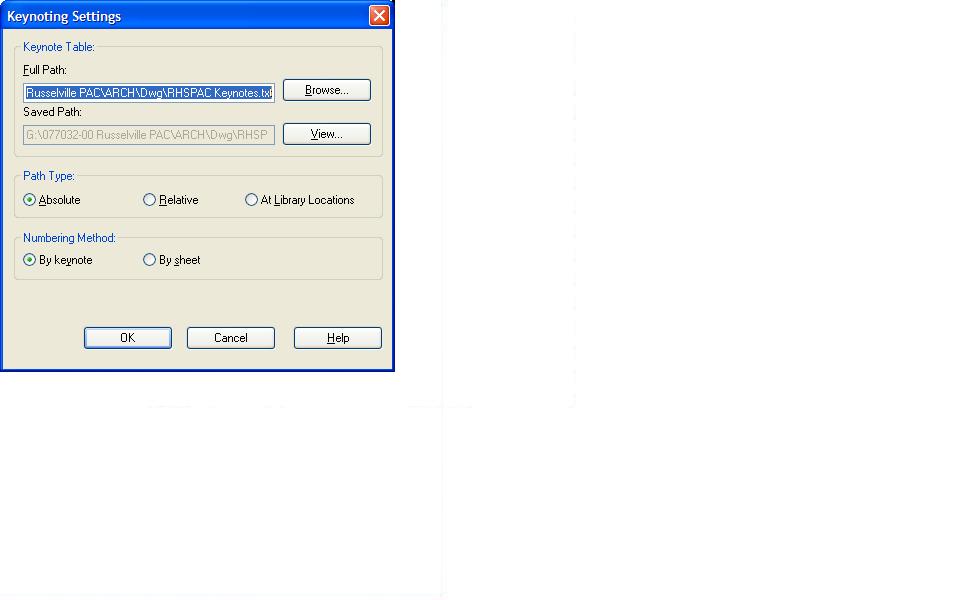

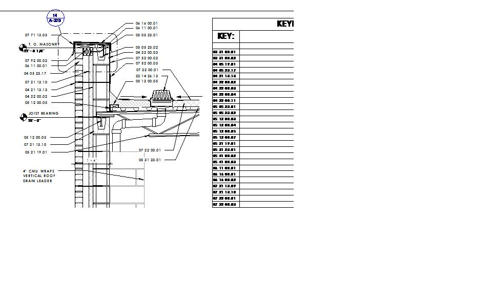

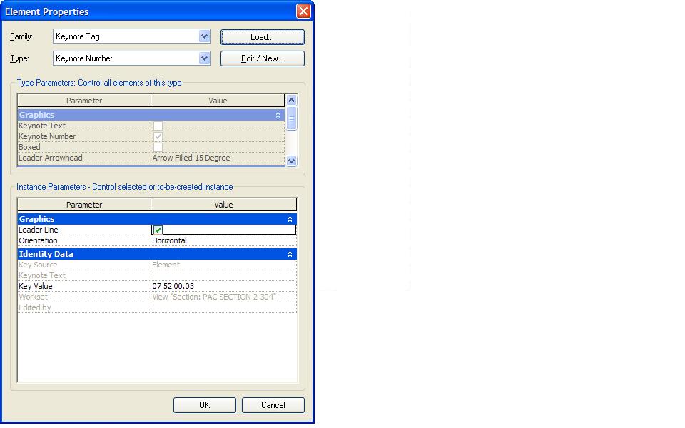

We have been using keynoting with our details with great success; however, we just had a user report the following problem:
The keynote text is no longer listed in the element properties box when you select a keynote and check the properties to see the note. The keynote number is also the only item now showing up in our keynote schedues on each sheet. The keynote settings dialog box appears to still be referencing the file, but notes are not present inside the project.
Does anyone have any ideas? Why would they suddenly dissappear?

OK, We're note sure how, but it would appear that the keynote file database had become corrupt. We restored a copy of the keynote file from the day before, and the notes came back.
