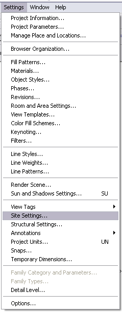

i am working with revit architecture and would like to know if contour lines can be made to show at different intervals in plan, and whether it is possible to customize to show major and minor contours?
VND

yes and yes, controlled within settings->site settings.  You can also control color, line weights, etc from visibility graphics/ overrides ->topogography

Quoting TABEST from 2008-04-08 17:16:41
"yes and yes, controlled within settings->site settings. "
see attached

Excellent, thanks for that.
