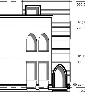

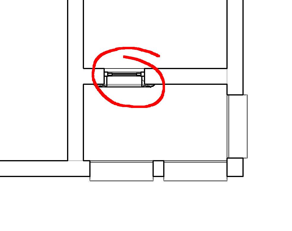

The window circled in plan view is visible in 3d view (elevation in color) but not in relevant building elevation (elevation in black&white) unless i hide the opening in the wall in front of it. And there is an apperant difference in shadowings of the elevation and 3d view oriented to an elevation direction.
What might be the problem with my building elevation view?

in the family, verify that when you click on the opening, that it is transparent in elevation views also... (once you click on the opening, this checkbox appears on the options bar).

thx for the quick reply. it worked!
 But it seemed strange to me that if is it by default this option is left unclicked?

yup, it is ALWAYS left unchecked, so be sure to check it every time, and I'm in agreement, it should be checked by default.

Maybe the reason is to avoid showing unnecessary lines inside the openings, such as an edge of a cabinet or door inside.
