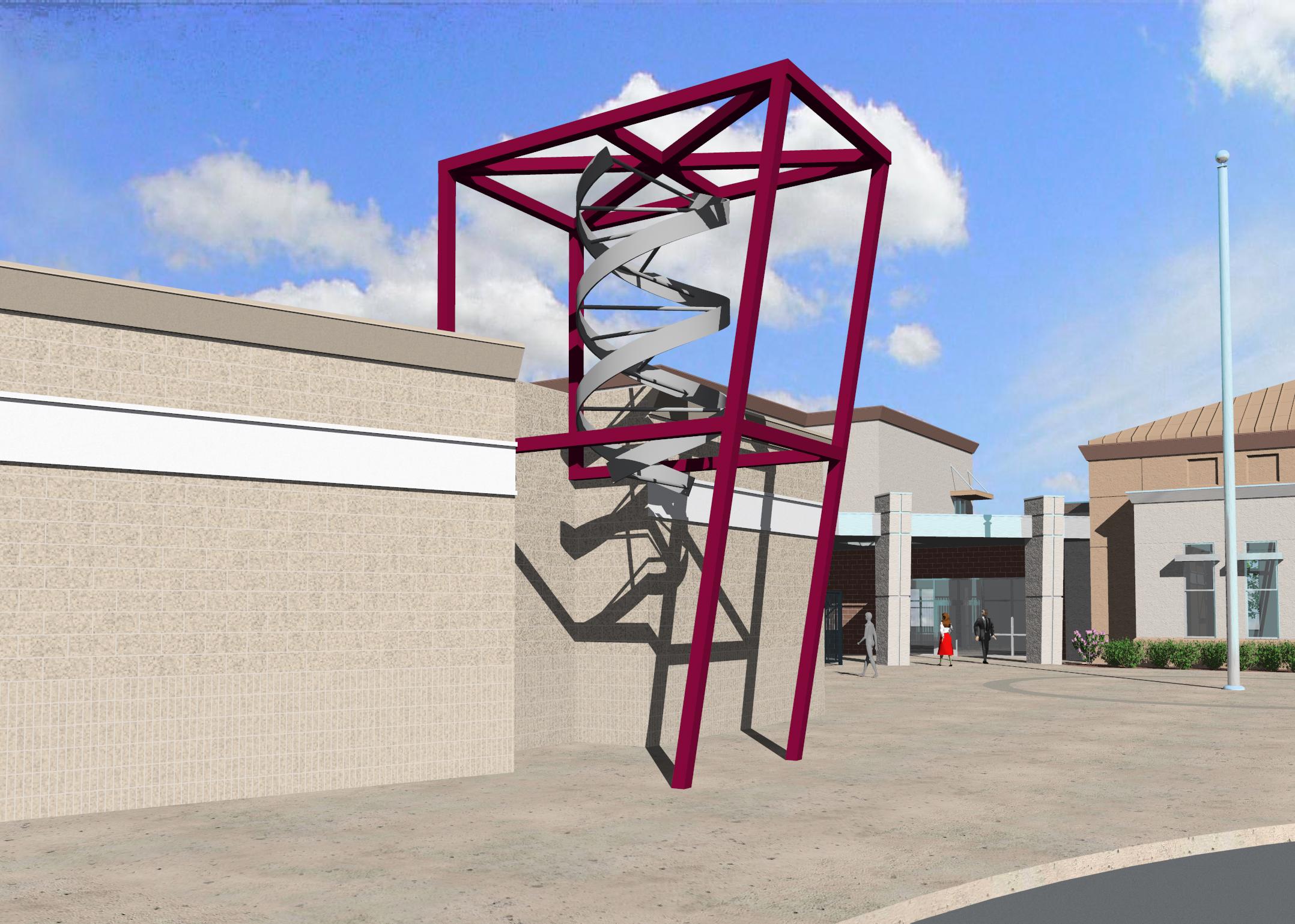

I ended up modeling it in AutoCAD & then imported it as a family into revit, just sucks though because the materials get all mest up & it doesnt render as nicely.

Here's a screen shot of how it came out if anyone is interested.

The materials should be just fine.  If you created the forms in autocad and seperated them by layer, you can assign the materails accordingly.  I have done that several times with 3d forms that I could not create in REVIT.

Is there a special trick to it? because I seem to loose the material & texture on the objects every time & revit won't let me assign materials to it.

shape you are trying to make can be made in revit 2008, use the stairs tool. spiral stairs
the other thing is what family did you import it into, try the mass family then attach wall to it might give you the result better.

When I did this, I created a family that I imported the cad drawing into.  Each 3d object that I wanted to assign materials to is on it's own layer.  When the family is then inserted, the layer name shows up in the project's materials file which is where you set it.  Not in the family.

As mentioned you can do this in Revit with some work and very easliy in Revit 2009 :o) but for now you can always model your helix in AutoCAD with it's helix command and sweep a shape around it, then import it back into Revit... just an idea.
