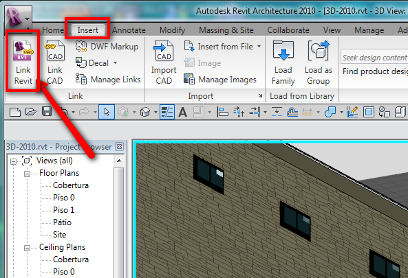

Sat, May 23, 2009 at 11:59:06 AM | HELP! Recovering Corrupted Files
Joined: Tue, May 22, 2007
5921 Posts
4 Stars: 205 Votes
What version of Revit are you working???
 See the images attached....
Sat, May 23, 2009 at 3:06:10 PM | HELP! Recovering Corrupted Files
kristin25
Joined: Wed, Mar 14, 2007
2 Posts
Thanks for your help, I found out that because my CAD file was in the revit file it caused it to be corrupt, I could save the recovery file without the CAD file without it becoming corrupt again.  Is there any other way to get around this problem?
