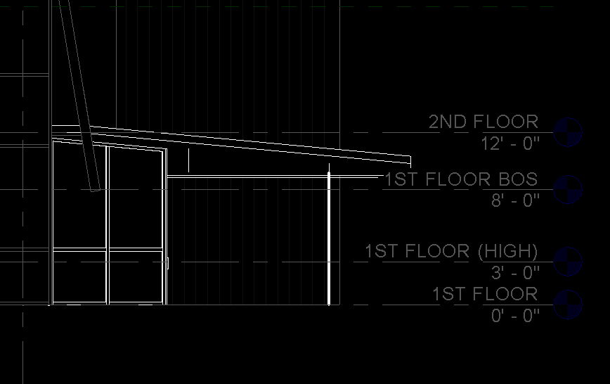

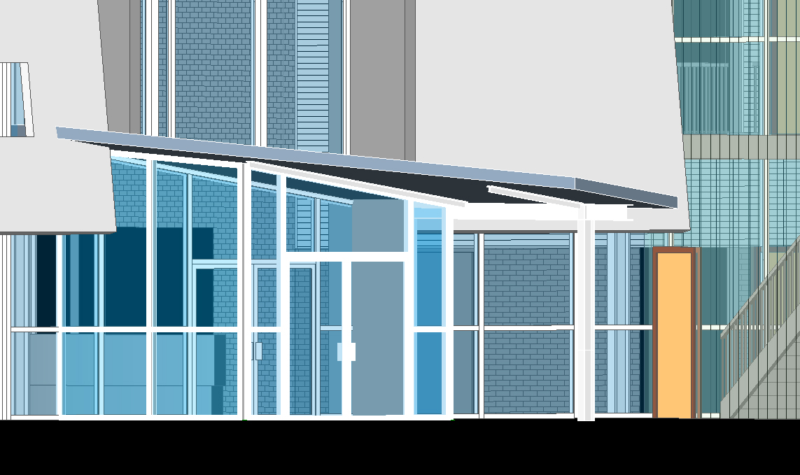

I’m using Revit’s structural tools to insert beams and columns.  They are showing up fine in plan and in the 3D views, but when I switch it over to elevation they only appear as a single line.  How do I make structure show up in elevation as the physical structure and not just a single line?  See screen shots attached

Change the "detail level:" to FINE and the "model graphics" to shading with edges... Hope that helps....
