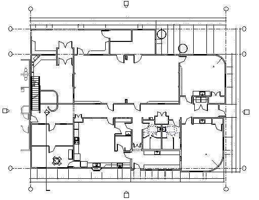

Hello,I have an issue I'd like some assistance with.  I've already searched the forums with no luck...
I have a few walls in my project that are horizontal, or at least they should be.  However, when i select them the the line of the temporary dimension that shows up appears to be very slightly rotated.  Also, the flip control appears to have some sort of rotation to it.  These indications lead me to believe that the wall is not aligned perfectly horizontal.  Also, when i use the demension tool - pick entire wall, it dimensions the window and door openings, however, when I then select the window or door, the applicable text of the dimension line on either side of the unit doesn't show up as "blue" (editable).
I have tried many things including drawing a new horizontal detail line and moving my controls of the wall on top of the line.  Same problem.... Any help here would be appreciated!
Thanks!Parley Burnett

have you tried dimensioning with an angular dimension to see if it is rotated?
